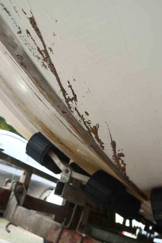

Finally, there's some minor damage to the underside of the hull and to the sealant & gelcoat on the stern (by the rear hatches) which I have been told by others is fine and easily repairable, what are your thoughts?

Hull: (High quality: http://i64.tinypic.com/20ixmxc.jpg)
Sorry about the angle on that last one!!

The fourth image looks like the hull keel area has been gouged up a bit due to loading it on the trailer with some sort of misalignment. The weight of the boat was bearing on something made of metal, much harder than gel coat resin, and the hull gel coat resin was gouged.
Off the four, the third image with the opened caulk line is the one I would investigate further. If the two elements are still securely fastened, maybe the caulk has just shrunk over time. But it would be a bit abnormal for the caulk to pull apart like that.

The trailer appears in the fourth image: it is a floppy roller trailer. This type trailer is not recommended for Boston Whaler boat hulls. You Boston Whaler will be much happier on a trailer with keel-rollers and some bunks.

I had no idea about the roller v. bunk trailer concern, nor did the current owner. I'll check for any visible signs of damage to the hull caused by the pressure of the boat on the rollers, and, if I do go for this boat, I'll replace the trailer with bunks. Perhaps I'll be able to negotiate a price reduction on the boat as a result.

From all the pics you posted the one I would be most concerned is the last one. To tell where exactly [the site of the photograph] is located is difficult. It appears [the photograph shows an area] below the water judging by the rollers next to it.
Also [the photograph] appears to show that somebody tried to do some repairs previously. You can clearly see round holes where some screws were added, and they shouldn't be there.

vze2gbs4 wrote:Hmmm- from all the pics you posted the one I would be most concerned is the last one - it is difficult to tell where exactly this is located but it appears its below the water judging by the rollers next to it . It also appears that somebody tried to do some repairs previously because you can clearly see round holes where some screws were added and they shouldnt be there.
The damage is either side of the keel, apologies that the angle of that photo makes it hard to view. The screw holes are affixing the keel guard to the centerline. Is this not how the keel-guard is usually attached to the Whaler's hull, should they not be there?

Boston Whaler boats don't come with keel guards from factory. The keel guard was added by the owner of the boat after the purchase.
I bought few boats with keel guard and peeled them off--only glue was holding them. I am not sure why your boat has holes with that keel guard. Perhaps [someone] thought screw-fasteners were needed.
You are in tough spot, [because of concern for] how well those holes are sealed. If they let water in and wet the foam [the hull will be] waterlogged.
That boat appears to be stored out of water due to lack of bottom paint is good; it suggests non-prolonged periodso f water submersion.
I would like to know what happens once you remove that keel guard and open all those holes. How much water will weep out?

With all-roller trailers and Boston Whaler Unibond hulls, you should look at the hull bottom in areas where the hull contacts the rollers for any sign of indentation in the hull; also, tap the hull with a small plastic-head hammer and listen to the sound of the tapping. If there is any delamination between the hull laminate and the interior foam, the report of the tapping will have a different sound.
The application of a keel guard to the keel centerline of a Boston Whaler is probably best done with a very strong adhesive and a pliable keel guard material. On this boat the fasteners look like rivets to me.
There is proper concern for the maintenance of a water tight seal for any fastener that enters the hull in any location that is under water, and particularly the keel. If the fasteners are rivets, I don't think you'd want to remove them all just to see if water weeps out. You can probably assess that by dunking the boat in the water for an hour or so, getting under way, then hauling the boat and carefully watching for any sign of water coming off those fastener holes as the boat dries out on the trailer. Or maybe drill out one rivet as a test. But don't become alarmed if a drop or two of water comes out. You just don't want a steady stream for ten minutes.

The image below will more clearly show the hull bottom, keel, and roller locations.
Regarding the trailer and its rollers: it looks like there are a lot of rollers; the more the better, as that means less weight bearing on each roller.
Regarding any repair of the hull bottom: I suspect that, if this 220 DAUNTLESS were my boat, I would proceed as follows with repairs to the hull bottom:
--completely remove the metal keel guard and its mechanical fasteners from the hull
--let the hull dry thoroughly so that there was no sign of any water seeping from the old fastener holds
--seal all old fastener holes with an epoxy resin and high-density filler mixture
--if future use warrants adding abrasion protection to the keel, then use epoxy to adhere some fiberglass cloth to the keel area, overlapping at the keel and extending about 2-inches (50-mm) up the hull on each side; cover this with more thickened epoxy resin with low-density filler. Tint the last batch of epoxy with some titanium white acrylic paint to improve the color matching. But I would only do this if the removal of the keel guard revealed some damage to the keel that warranted reinforcement
--or, apply a non-metallic keel guard after preparing the hull bottom and sealing any old fastener holes
