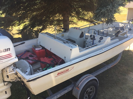

Before Photo:
1987 17 Super Sport Limited
