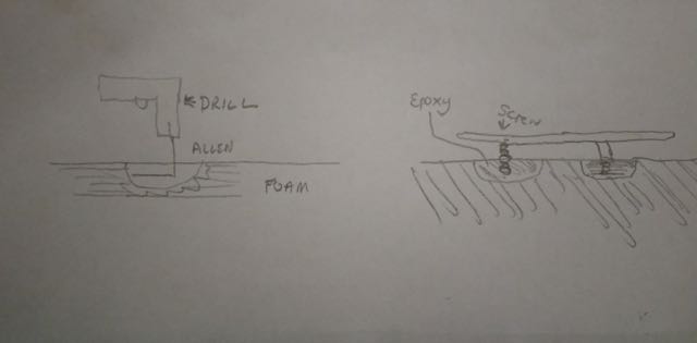

You lost me there with the "hockey puck" method.??

I learned this from a CW veteran and used it several times.
When adding a screw in a location without backing material, additional support is warranted.
In a foam filled hull, one method to add support is as follows:
Position cleat , mark holes for screws.
Remove cleat. Drill 3/8 holes.
Insert short end of allen wrench in drill. Insert long end into hole and use slow speed
Suck out any foam pieces.
Tape off area to protect gelcoat.
Squirt Gorilla Glue (expanding epoxy) into holes. Wipe off excess. Let cure.
Retap holes for screws.
Rough sketch:

Phil -- That's a great tip. I didn't realize the Gorilla Glue was that durable. It's good to know it will hold screws securely.
