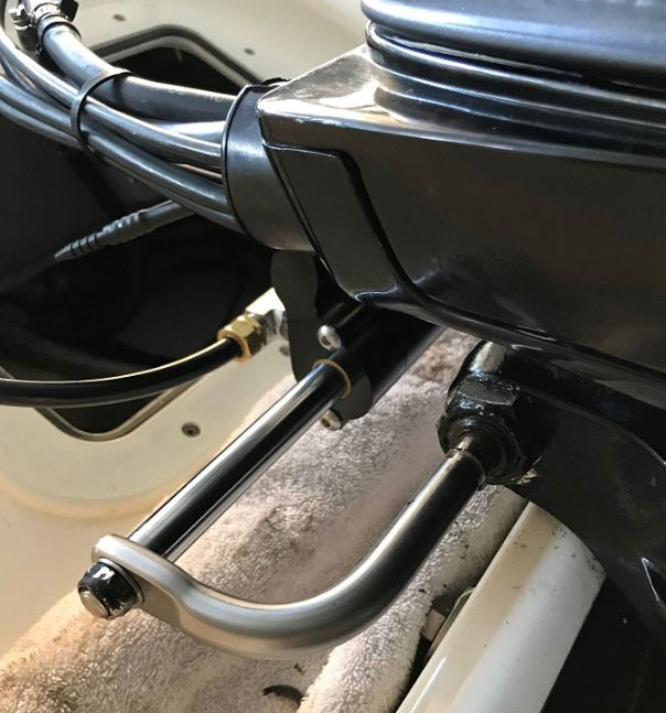

Bob (and others)--I have installed a hydraulic steering kit [possibly a BAYSTAR kit that is being discussed in this thread--jimh].
Fig. 1. Completed installation.
I experienced a problem when I tried to insert the [support] rod into the port side [of the engine tilt tube]. After some twisting and shoving, the [support] rod went in[to the engine tilt tube] but became stuck.
I could not push [the support rod] forward or backward. I could rotate the rod without any problem.
There is a nut [perhaps referring to the nut that retains the TILT TUBE on the engine mounting casting]. I tried [to move the nut by rotating it] both clockwise and counterclockwise.
The rod is stuck, but I was able to screw the support arm to the shaft.
Please look Fig. 2. below.
Q: is the outside groove normal?
Thanks.
Fig. 2. Position of machined groove in port support bracket rod now stuck in position.

Hi Jim--Thank you for clarifying post and for the link.
I read that manual page by page before the work. Prior to inserting the support rods, I cleaned the [tilt] tube with WD-40, then put some Quicksilver marine grease 2-4-C in both ends of the tilt tube. Then greased the support rods with the same marine grease.
The initial insertion of the support rod on the port side was stuck. My initial thought was maybe [the tilt tube] needed more cleaning. I put a flathead screwdriver and scraped out a few gunks. After that, I was able to insert [the support tube] and rotate it--and it stuck. I don't want to bang it out. I am afraid I might damage the tilt tube.
Maybe others experienced similar difficulty?

It bothered me that I could not get the support rod out [from its stuck position in the tilt tube] while I was able to rotate it freely.
I remembered I looked through the [tilt] tube and cleaned out [the tilt tube] before I inserted the [support] rod [into the tilt tube].
I used a hammer and tried to tap out [the support rod from the tilt tube] but [it did not come out]. I tried with all my strength for 10 minutes [to pull out the support rod from the tilt tube] and gave up. I thought [the support rod] had some kind of one way lock mechanism--but that would be a flaw design if people need to replace the [support] rod in the future.
I put a metal rod I had on hand through the other side [of the tilt tube]. I tapped [the metal rod] a few times and [the support rod] came out [of the other end of the tilt tube].
Upon inspection, I saw an O-ring at the entrance of the [tilt] tube (not on the starboard side) [thus probably on the port side]. When I inserted the [support] rod [into the tilt tube on the port end], I had to push [the support rod] a bit hard, and [the support rod] stuck at the first groove on the rod. But, after I tapped [the support rod] a bit more, [the support rod] went through [the opening of the tilt tube past the first groove on the support rod].
I then used the metal rod to tap out [the support tube from the tilt tube] again, on the other side. After the second [insertion and removal], now I can freely insert and pull out the [support] rod [from the tilt tube].
SUPPORT RODS MOVE
After I installed the hydraulic steering, when [the steering wheel is] turned left and right, the support rods move in and out of the [tilt] tube about 1/4-inch.
I am not sure if [the movement of the support rods in an out of the tilt tube as the steering is operated] is by design--but everything seems solid.
This installation was my first time doing this procedure. The installation is really fun but it took two days.
