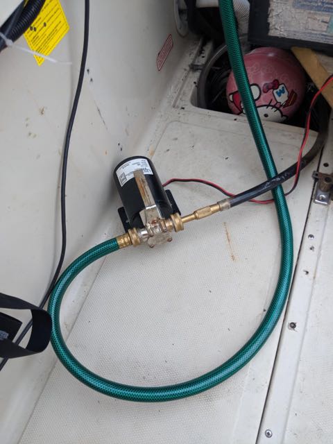

I decided to go with Coosa board under the 4 x 10-foot section of deck that I will take out. I am going to skip foaming [the fuel tank into the fuel tank cavity].
I will add a self priming pump hose [at the aft end of the fuel tank cavity] to remove any water that gets into the fuel tank cavity. I have seen SHURFLO-brand pumps mentioned, but no specific model. I want [a pump that can lift] any water out of the [fuel tank cavity], something like this:
or this:
Give me a recommendation for a suitable pump [to lift water from the fuel tank cavity].
Also recommend material for the tank to sit on. I have anything from nothing to yoga mats to AZEK-type trim bonded to the tank with 5200.
Re: 1986 Outrage 20: Water in Fuel Tank
Posted: Mon Apr 20, 2020 8:02 am
by jimh
Re a recommendation for a pump to use to evacuate water from the fuel tank cavity:
Consider a diaphragm-type pump such as a JABSCO 240 GPH Diaphragm Bilge Pump. This pump is self-priming and can lift water six feet vertically to the pump. With this type pump you can mount the pump in a convenient location and just route a hose from the bottom of the fuel tank cavity to the pump. See
https://www.go2marine.com/jabsco-diaphragm-bilge-pump-general-purpose-4-gpm-12-volt-36960-2000
Jabsco, Diaphragm Bilge Pump, General Purpose, 4 Gpm - 36960-2000
The manufacturer says:
Jabsco Diaphragm Bilge Pump for General Purpose and sump pumping. Open flow rate of 4 gpm this pump may be used for deck washing as well.
  • 6 amps@ 12 volt with 4 gpm
  • Self-priming to 6', allowing installation above the bilge and sump area
  • Design allows pump to run dry for extended periods without damage
  • Has a tough plastic body with 3/4" ID ports
  • Meets USCG and NMMA standards
  • Complete with Pump Guard Strainer
The inexpensive 37202 and 36960 series include many of the dependable features of the classic Jabsco PAR pumps. They are ideally suited for bilge or shower sump installations and come complete with a 3/4-inch suction strainer. They will prime up to 6-feet and will run dry without damage.
I have first-hand experience with a similar pump. I installed one to lift bilge water from the deep sump of a sailboat keel. The JABASCO PAR diaphragm pump easily drew water vertically upward about four feet from the bottom of the sump, then aft several feet into the pump, and blasted it out a transom exhaust fitting at high velocity, throwing it several feet astern. Previously, a centrifugal pump had been installed in the keel sump, and it was entirely unsuitable. Centrifugal pumps cannot tolerate much head on the pump, that is, they cannot lift their output water very far vertically. And, of course, they cannot prime themselves, so they must be lowered into the water they will remove. The JABSCO pump was a great improvement over the centrifugal pump that was previously soaking in the bilge water and unable to remove any water.
The basis for my recommendation to you to use this pump is to remove the pump from the fuel tank cavity itself. This allows the electrical motor that runs the pump to be located away from the fuel tank and any possible gasoline vapor. This eliminates running electrical wiring into the fuel tank cavity.
The price today almost double what I recall it cost 30-years ago. I don't own that boat anymore, but I bet that pump still works.
The problem for use on an OUTRAGE 20 will be where to hide the pump, as it won't look great sitting in the engine splash well.
I hope you find my recommendation and my explanation of the basis for the recommendation to be useful in response to your request to give advice and recommendation for a pump to remove water from the fuel tank cavity.
