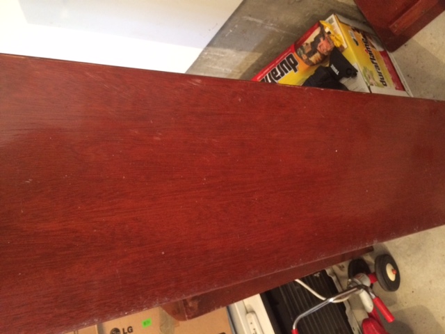

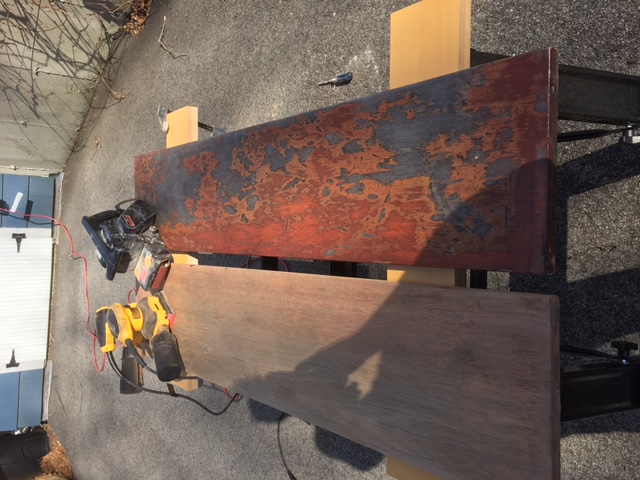

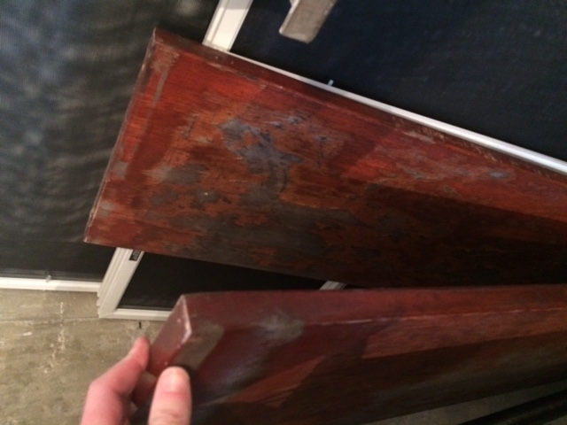

I am getting ready to sand and re-varnish the mahogany on my 1977 SPORT 15. The previous owner did a great job on the wood in 2012 but did not keep it covered as well as he would have liked too. The topside wood needs to be sanded down completely but the bottom looks mint--not a scratch and has never seen the sun.
I am wondering if I should leave the bottom side alone and just do the sun-drenched top as well as sides? Or, should I do a couple coats on the underside? Or none at all?
I am meeting with [the previous owner] in a few week to get find out the brand and stain he used so I can match everything.
The last picture shows the good side (scratches on sides are just dust and crap and wipe off)

I guess I am still trying to figure out if I can leave the mint side (pic 3) alone.
If the last stain and varnish is in perfect shape on one side. Do I need to sand it down and start over or can I just hit the top peeling (sunfacing side) and edges of the board to make sure its all sealed and leave this side in picture 3 alone.

just do the top, exposed sides. for sides that are almost never exposed to the sun, since they are already finished, no need to sand and refinish.
every time you do this, (every couple of years, usually) you re-evaluate the unexposed surfaces.

BlueSmoke I don't agree with not re-finishing the "good" side as goldstem said.
Yes you don't have to go to the bare wood but at transition from bad to good you must sand more aggressively and wet sand the "good" side and when getting to the final coat of the "bad" side cover it with 2 more coats too.
Bottom line for varnished wood to look good and last thou must sand and varnish many times.
Even if you and up with a slightly different hue between bottom and top it still will be sufficiently protected.

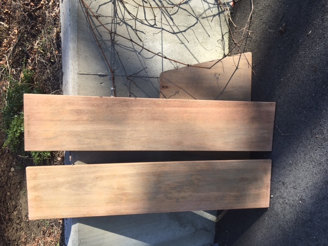

thanks guys! I am thinking the wood would be prety good eaither way as it is in such good shape and never seen the sun covered 70% of its life. That being said the hard work is in the sanding down to bare wood, not the varnish/ rough sand repeat.
Makes sense and not that much extra effort to rough it up and add a few extra coats while I am doing it anyways and the wood is already removed, painting station set up, and brushes wet...
sanding starts on Saturday!

Got down to it today in the 70 heat wave in Boston!
Started with 80 grit on the belt sander - very light touch to get the old varnish off
moved to 100 on the palm then 120 on orbital.
What grit do you stop at before next step?
forgot to buy tackcloth and was getting late in day so decided to stop there.

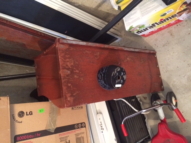

after pics with anchor hatch too. not pictured is side console.

You can start the finish after 150 grit or 180 grit sanding. Be sure to wipe the board down with a tack cloth before adding finish. Then 220 grit between coats if you let it cure (see instructions on the can). 220 grit before the final topcoat. Since you've taken it down to bare wood, you will want many coats of varnish. I'm talking, like, 10 to 12 coats.
