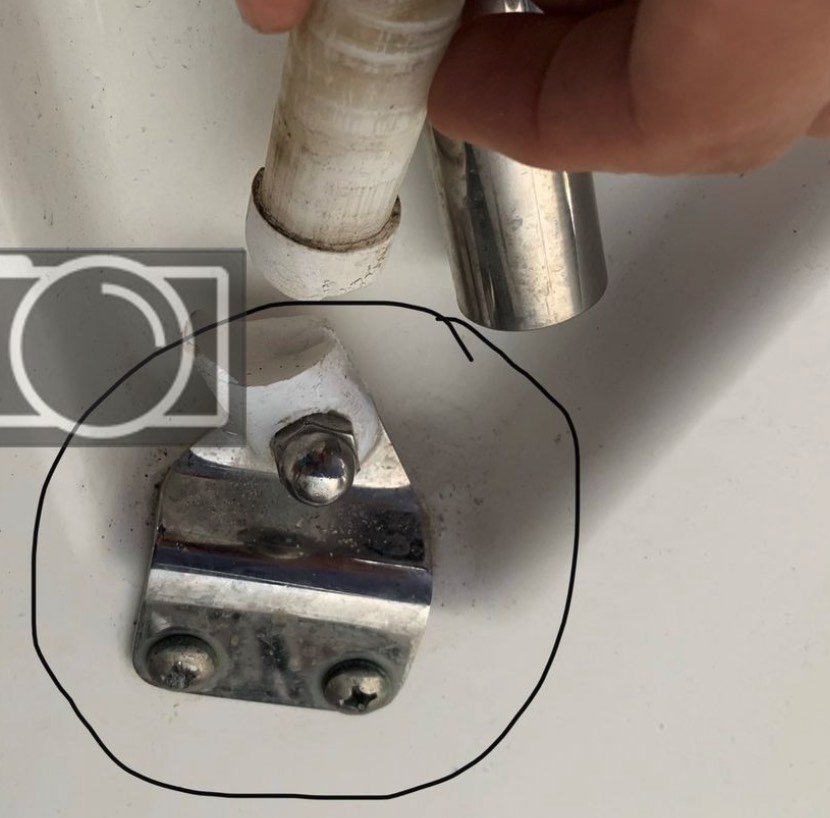

My 2010 Dauntless 200 has the pilot seat with live well. One of the [seat back frames] is broken. I do not know how to remove the stainless bracket [associated with the hinge for this frame]. I have no access to the nuts inside the [integral live well under the seal].
[Seeks advice on how to remove the fasteners holding the stainless steel bracket on the seat-live well on a 2010 DAUNTLESS 200]
Thanks

Thanks for the tip, the problem is that I don`t know how to remove the screws to replace the part.

My seat is shown [in SHEET 3 of the linked drawing set mentioned above]. My seat has the integrated live well. I don`t have access to the fasteners inside.

If you just want to remove that acorn nut on the hinge that holds the frame to the hinge, use Vice-Grip or similar pliers to hold the machine screw; you will have access to it through the broken plastic tube. Then unthread the acorn nut from the machine screw. The machine screw or hinge bolt may be captivated inside the seat base.
Since that plastic end fitting is broken, if it interferes with holding the hinge pin in the Vice-Grips, just cut or grind the plastic end fitting out of the way.

I have this same problem. Both sides of the RPS plastic delvin pins have broken on my 2011 Dauntless. Same problem: I cannot access the nuts on the inside to remove this part.
