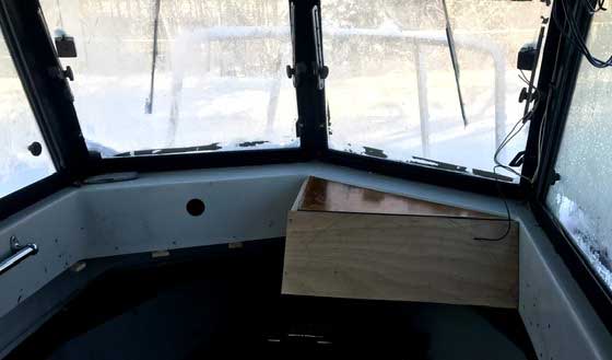

I started mocking up the new dash yesterday. So far this is just the right hand side. I’ll start the left side when I can get to it. When I get it mocked up I’ll epoxy it together and start making fillets with thickened epoxy and start sanding. Then it’ll be time to glass and fair the dash insert and then glass it in place. More to come later.

Re: 1986 FRONTIER 25 Rebuild
Posted: Mon Feb 03, 2020 11:09 am
by biggiefl
Would you just replicate the one you made as it looks like the dash is the same on both sides?

by quickenberger
I think having the left side built like a tray would be better than a full dash spanning the cabin. The forward "V" shaped section makes it a difficult area to work with so I'm thinking a tray would be better than a glove box. I could mock something up and see if it looks right and makes a good use of space.
Posted: Mon Feb 03, 2020 1:37 pm
by biggiefl
A tray with a lid(plastic or wood) would work well.
