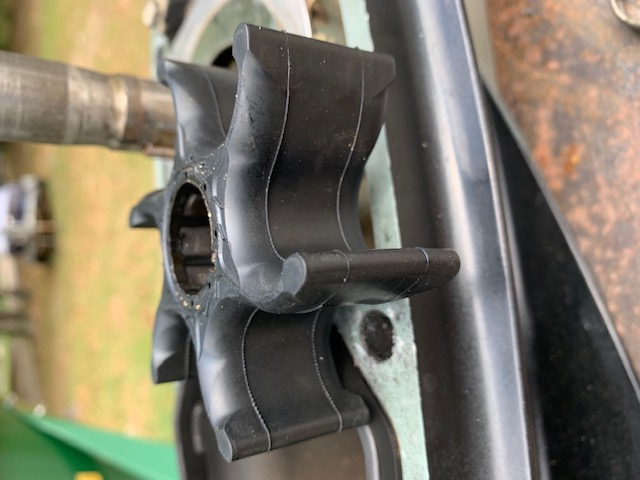

It seems that with self quarantine and no desire to be around others finding stuff to do and new ways to do them is a priority these days. So in the last few weeks I have changed my outboard engine oil, lower unit oil, inspected the prop and prop shaft, diagnosed a not working fuel level sender ( float don't float), replaced tilt and trim cylinder seals, and today replacing the water pump impeller. I found a novel way to support the lower unit while changing the impeller. One has to be blessed to have a tractor or forklift and the fortitude to do this job. Take note that I clamped the ends of the forks to prevent them from spreading out and dropping the lower unit on the concrete. Below are a few pictures of my work and a last shot of the not so worn out impeller. Total cost for peace of mind was $37.28 for the impeller and about two hours of my time and three beers.

No chance Con. I don’t even need to look at the driveshaft cost to say no way. But I was foolish in doing it by hand by myself. One screwup and the $$$ could be exponentially greater.
