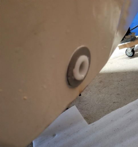

Fig. 4. Please add a caption. The only object in focus is a cart in the background.
transom tube.jpg (232.58 KiB) Viewed 2790 times
Completed the drain tube. Came out great and is easy to do!
