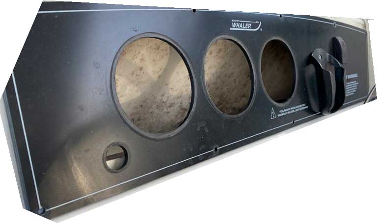

What type of plastic [was used to make the instrument panel for a 2001 CONQUEST 23]? The finish in a matte black.
Fig. 1. An instrument panel made by Boston Whaler for a 2001 CONQEST 23.

To deduce the type of plastic from the image is very difficult or impossible. Generally I have seen that Boston Whaler instrument panels often are made with a plastic material that has a black surface and a white underlying material, and the lines, logos, and legends are engraved into the panel, with the engraving resulting in white letters on a black background. I do not believe it will be possible for you to duplicate an engraved panel. To duplicate a non-engraved panel will be much easier.
However, this panel just looks like it was made from black plastic, and the lines and legends are applied to it, and making a similar replacement will be much simpler.
I don't think there is great concern about the exact material for the black plastic. Almost any black plastic sheet of appropriate thickness ought to be workable.

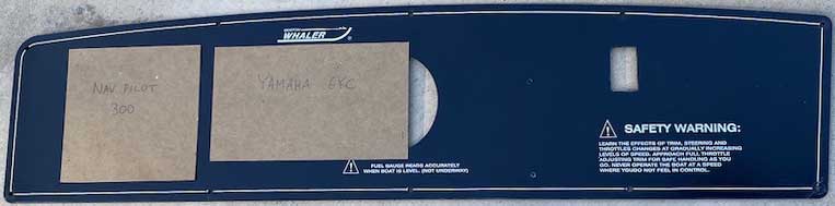

So I'm back to searching for ABS blanks where I can cut the exact shape I need. I have experience working with ABS plastics in car stereo panels. I feel comfortable with these relatively inexpensive plastic materials. The cuts can be made with good working tools, and a Dremel type rotary tool can make the rectangular holes I need.
kwik_wurk, --that panel you have there looks fantastic. That's the OEM look I'm after.
Locally there's a chain called Tap Plastics. They did not have the plastic stock I want but they tell me they can cut plastics if I bring my own material.
I have time to work on this because the new outboard won't be delivered intil Jan 2021. In the short term, I may just fill in the one-third of the circle left on the existing cutouts.
Fig. 4. Another view of the OEM instrument panel with cardboard rectangles covering parts of the panel.
