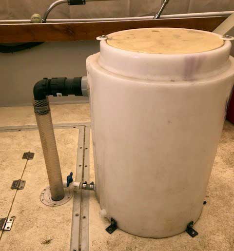

New On-deck Bait Tank
Fig. 3. The new on-deck bait tank.
The plumbing you see is for removable live bait tank I mounted on the deck of the boat. The plumbing is also a supply hose for a wash down pump line that can be seen [in Figure 2] going through and down the port side rigging tunnel.
The raw water supply is plumbed through a 1-inch ID fiberglass tube (which has been] threaded for the elbow fitting. This travels through the original engine splash well into the original live well just below the deck cover. For additional strength and clearance, all of the supply manifold's PVC tube and valves are mounted to the side of the original live well on 1/4-inch plywood pads coated with epoxy that are epoxied to the side of the tank. .
I designed the live bait tank to be easily removed or installed in a matter of 5 to 10 minutes utilizing cam-lock valves on the supply and drain.
All of the plumbing for the tank goes up through a 4-inch circular deck access plate for which I have two plate lids. One deck plate lid with holes in the lid for the drain tube and supply hose. Then one original for use when the tank is not in place.
To mount the bait tank on the deck for easy removal and not lose the nut under the floor. I welded 1/4" stainless nuts to big stainless body washers. Then drilled I made small holes in each body washer so they could be screwed in place under the floor cover over my fuel tank. Then I mounted the tank using the welded nut-washers and installed stainless screws up into the floor cover which will hold them in place when the tank is removed. The live bait tank sits directly over the original aft deck plate on the fuel tank cover so you have to do all of this while you have both the fuel tank floor cover as well as the original fish box cover removed.
