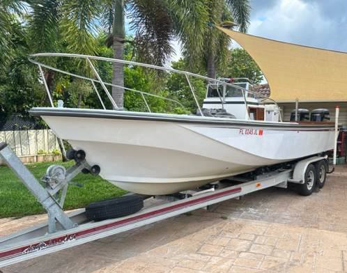

Introducing "Mutation"--formerly a 1998 TEMPTATION 2500, and now converted to an OUTRAGE 25 Whaler Drive
We are happy with what we have and the relatively small investment. The hull is in superb shape and has never had bottom paint.
Fig. 1. A 25-foot hull.
Twin Yamaha OX66 250s are fitted and rigged with Saltwater Series II propellers in 21 pitch.
Fig. 2. Twin engines.
A few electrical things to sort and we should splash this week.

The conversion to an OUTRAGE 25 Whaler Drive from the original TEMPTATION 2500 looks very good.
The Yamaha Ox-series engines are perhaps the nicest example of two-stroke-power-cycle engine of their time.
You should give us a narrative of how you were able to separate and remove the molded upper deck structure of the TEMPTATION, and how you repaired the remaining OUTRAGE-style hull from any penetrations of fasteners for the TEMPTATION structure.
Also, I suspect there were many little details to get correct along the way, and to hear of them would be illustrative of the tasks you have performed in making this conversion.
In FIgure 3 the gunwales and cockpit gel coat color looks like a pale blue, but the Super Console looks like Desert Tan. Are the colors in that photo being shown as they appear?

The gel coat on all of the hull is in fact the Temptation white. The the live well/leaning post, acquired from a 90s post classic Outrage, is a close shade of white; it just looks bluish in the photos.
The super console, correct vintage to the hull, is still in desert tan. We still have not figured out what to do with it yet.
