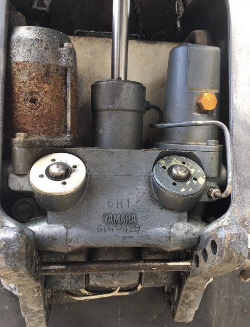

BACKSTORY: [A 1987 Yamaha 70-HP outboard engine has a] trim unit that likes to squeal when it reaches near the bottom, the last 20-percent before fully down. I notice some fluid dripping from the starboard trim piston. The trim "unit" is labeled 6H1. I think newer [trim "units") are [labeled] 6H1-10 or higher. I think [the leaking starboard trim piston] is the cause [of the squeal or vice versa].

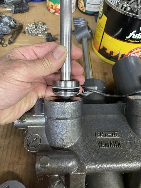

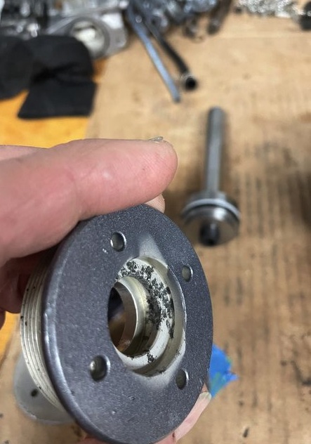

Once the trim caps have corrosion under the seal they are no longer any good and time to replace since they will leak fluid. There are 2 style caps and one has just the seal seated into a recess, the other has the same seal setup, but below that there's a second groove with a nylon split washer and r-ring and I believe that's what you have.
Fig. 2 and Fig. 5

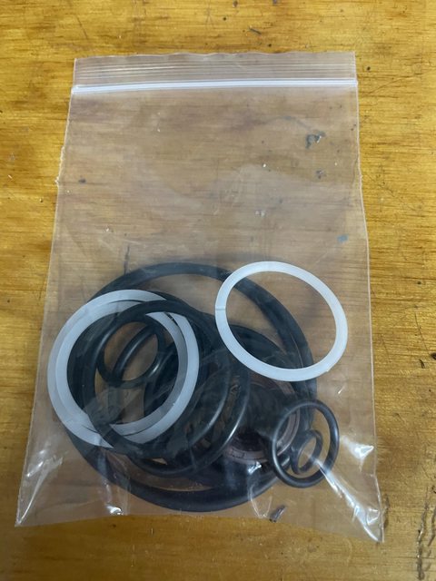

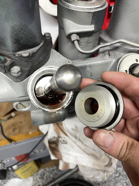

If it's leaking past both of those, you may also need the oring and nylon split washer on the piston itself, picture below.
Fig. 3.

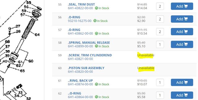

This is a typical rebuild kit (Yamaha does not offer a kit). I'm not overly happy with the trim seals, but aftermarket is the only way to purchase the tilt ram seal since Yamaha does not offer it and wants to sell you a $700 part when it's only a bad $12 seal....
Fig. 4

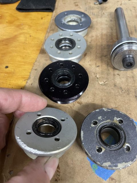

Here's a pic of a bad trim cap. You can see the additional groove below where the seal seats. That groove is for the nylon split washer and oring.
Fig. 2 and Fig. 5
Here are some various OEM and aftermarket ram endcaps for various Yamaha trim units. If there is any damage to the shiny trim pistons (rust, nicks etc) this will damage new seals if installed and the piston should be replaced. You can try a newer style cap as the threading is the same, but I'd also to the oring and nylon split washer on the piston itself.
Fig. 6

Based on the pic you texted me (below). You have the older trim motor that uses 3 wires - black, green and blue.
Fig. 7.
1. Black is negative
2. Blue is tilt/trim up when B+ is applied
3. Green is tilt/trim down when B+ is applied.
Newer trim motors are 2 wire.

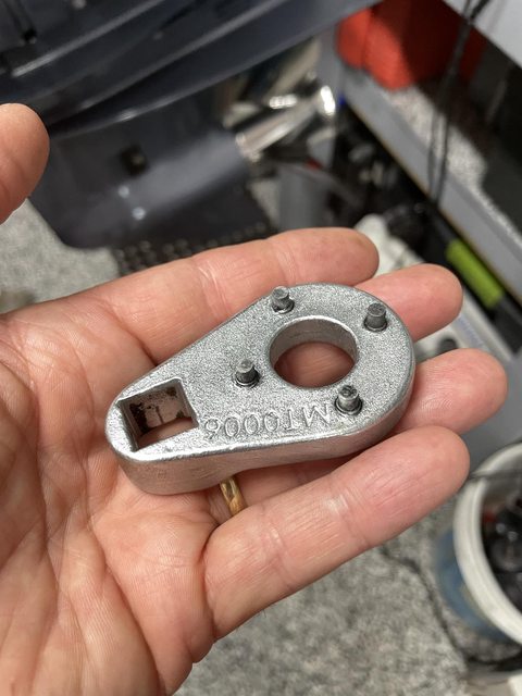

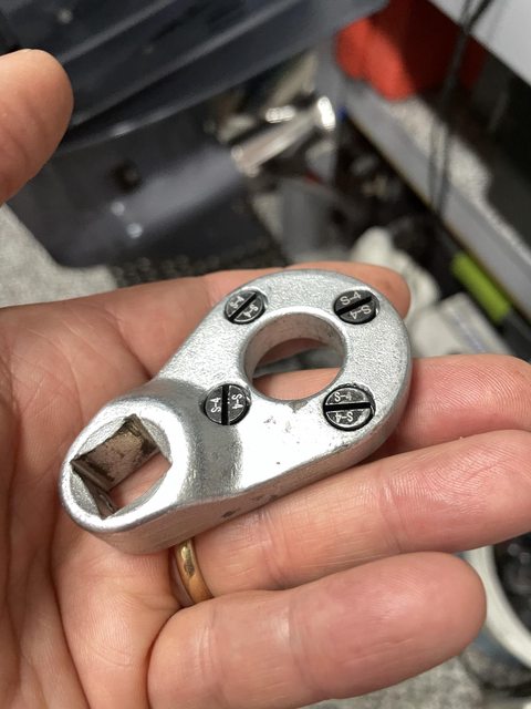

Fig. 8
The ideal tool is the 4 pin, they have 2 and 3 pin options, but I find they shear pins when applying lots torque, which older units require after corroding on. DO NOT use an impact gun, use a long ratchet and make sure they pins stay fully seated in the trim cap detents. The pins are replaceable, but once the cap detents are stripped, you're all done and may have to use a pipe wrench.
Fig. 9
FIg. 10
D-

The tool recommended above [and seen in Figures 9 and 10)] to remove the end caps worked great.
