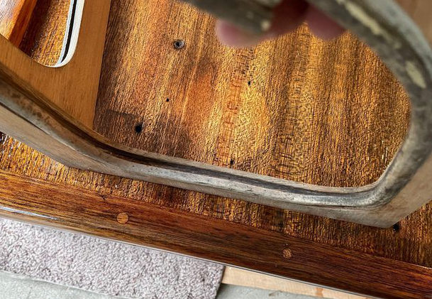

3). What is the correct orientation of the gasket? My guess (shown in pic 2) is the longer side of the gasket goes into the groove, with the other side of the gasket facing the outside of the windshield. This seems pretty obvious, but I just want to double check my logic.

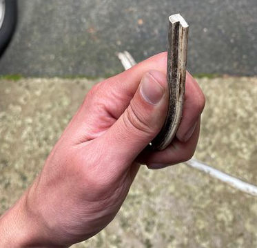

Fig. 1. View of the one the OEM asymmetrical gaskets. The long side is on the right; the other side is on the left.
Fig. 2. The orientation of the gasket I think is correct. I am also assuming this is the where bedding compound should be put.

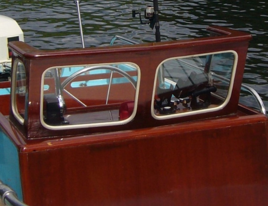

That does not appear to be the correct gasket. See Figure 3 below for reference.
Fig. 3. View of NAUSET console windshield with OEM gaskets.
