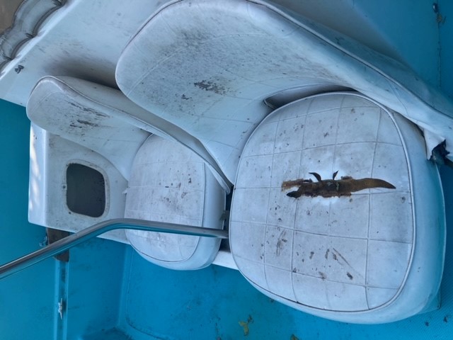

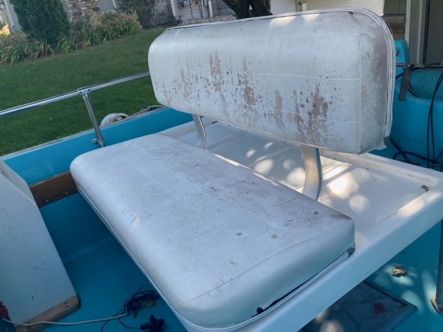

I am beginning restoration of a 1970 Katama 16 boat. The upholstery is in poor condition.
I am not particularly interested in retrofitting modern seats.
Q1: what options exist for restoration of the original upholstered seats?
Q2: is a direct replacement seat available?
Q3: is hiring an upholstery shop to restore the original seats the best option?
Thanks for your advice

OEM replacement would be Anderson's in Florida.
http://www.amfg.us
If the foundations are in good shape, have a local shop rebuild with foam and vinyl.
Sue Lodel at Twin Cities may have a recommendation on a shop in the WI/MN area.
http://www.beacontcm.com

In case anyone's curious, I've received unofficial quotes for $1200-$1600 from the local upholstery shops to restore the two bucket seats and the bench seat.

If you are looking for a possible alternative.
I have seen the two seats replaced with rod back cushions and a full seat cushion from Andersons.
Ask Tena to quote you. Could be less and OEM quality.
Come to think of it, they might offer the seat in its entirety.
http://www.amfg.us
