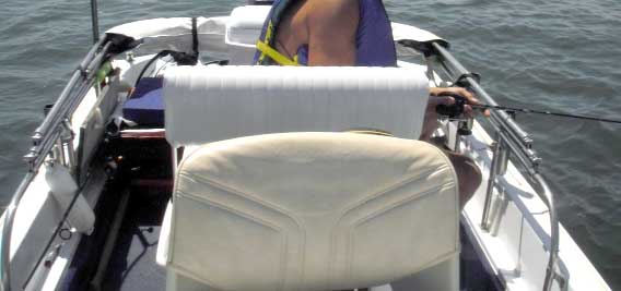

[To mount the frame of a bimini top on a 15-foot classic hull,] I used the side rails.
The Bimini top frame was stainless steel, and it came from another boat so some bending was necessary.
The top fabric was Sunbrella.
[The Bimini top] folds down and lays flat at the stern [of the classic 15-footer]
[The Bimini top frame] is clamped to the side rails with stainless Bimini mount hardware.
[On my classic 15-footer there are] two stern seats that the backs rest against the folded Bimini top rails.
The Bimini top out of sight when folded down.
Fig. 1. Bimini top on 15-footer with frame collapsed and top folded.
FIg. 2. Erected BImini Top on 15-footer

[The frame railings for the Bimini top on my boat that are mounted to a hinge on the original boat railings] lay flat on the side rails.
Fig.5. Added rails for Bimini top lay flat atop the original hull rails. For an additional view refer to Figure 1, above.
[Regarding the choice of fore-and-aft location for the hinge] the Bimini top wrapped in the boot [when folded down] lays [aft of] the [custom made and added] stern seats [on this particular boat]. Also, the engine when tilted up does not hit the top. The top is as out-of-the-way as it can be.
