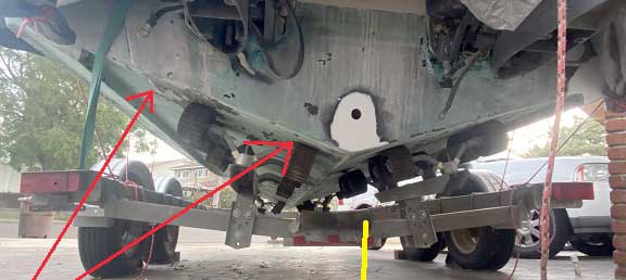

Fig. 1. View of boat hull while on trailer.
Q9: is the keel roller seen in Figure 1(partially obscured by a jagged yellow line) in the proper location?
In Figure 1 above the two red arrows point to where where I plan to install two bunks. I plan to install the bunks without lifting-up the boat, using this method:
  • install the outer bunks first, placing them against the hull
  • remove the original rollers, brackets, arms, mounts, etc.
  • install the inner bunks
Q10: can the above procedure be accomplished without lifting the boat?
I may jack-up the boat a tat, then drop it down right away after all the original rollers are removed.
Q11: will the only the two outer bunks [be] strong enough to support the boat while installing the inner bunks?

rnln wrote:Q9: is the keel roller seen in Figure 1 (and partially obscured by a jagged yellow line) in the proper location?
Yes. All keel rollers are located exactly on keel centerline. That one appears to be held by welded-on brackets. There is no contact with the hull. The keel roller is not supporting any weight. This is typical for the aft-most keel roller. It only has contact with the hull keel at the initial point of the boat being loaded onto the submerged trailer. As the boat is hauled forward, the hull comes into contact with the bunks and other keel rollers.
Typically if the trailer has keel rollers, the inner pair of bunk boards will be located as close to center as the keel rollers permit.
rnln wrote:In Figure 1 above the two red arrows point to where where I plan to install two bunks.
The outer bunk boards would typically be farther outboard from keel center line than your plan shows.
rnln wrote:Q10: can the above procedure be accomplished without lifting the boat?
Perhaps, but working under the boat while on the trailer will be very awkward.
rnln wrote:Q11: will the only the two outer bunks [be] strong enough to support the boat while installing the inner bunks?
Yes.

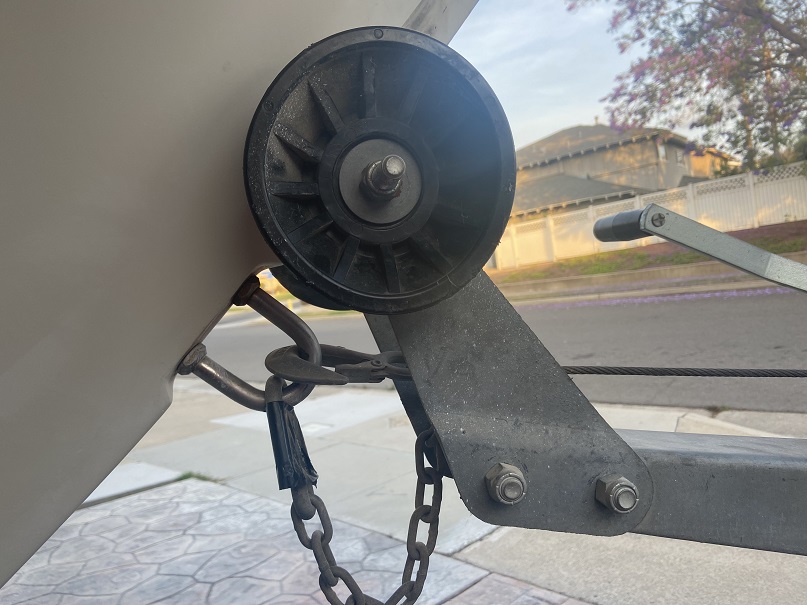

Also regarding bunks: the large flat surface of the bunk board should be able to be oriented so the entire flat surface of the bunk meets the hull, not just some small portion or a corner of the bunk board. To allow that to occur, the bunk boards are usually mounted to hinged swivel mounts so the board can articulate to meet the hull surface. Some so-called bunk or "float-on" trailers use very large nearly square timbers, and the only part of the bunk that touches the hull is the inboard upper corner. That type "bunk" is not appropriate.
Fig. 2. Detail of keel roller and inner bunk positions. The inner bunks are located just outboard of the keel roller frames.
Figure 2 illustrates the position of the inner bunk relative to the keel centerline: as close as possible and limited only by the roller brackets.
Also not that on this particular trailer the trailer frame crossmember is not straight; the crossmember is bent downward in the center. This is often seen on trailer intended for larger boats. The effect of this with regard to installing keel rollers is the often the standard brackets for the keel rollers won't have enough height to position the roller to meet the hull's keel. As seen in Figure 2, the crossmember has been drilled with two new holes for the lower bracket mounting bolts. These holes MUST be drilled on the exact centerline of the crossmember (to prevent excessive weakening of its strength). With the lower mounting hole now able to be raised several inches by the new lower hole, the keel roller bracket can be raised far enough to meet the hull's keel and support it.
Note also the paired keel rollers and their brackets. Mounting in pairs greatly simplifies mounting hardware, doubles the support, and usually has no increase in labor; of course the costs are doubled, but worth the added expense in my opinion.
When drilling the hole be sure to apply galvanizing or paint to the hole to inhibit future rust.
Also illustrated in Figure 2 is the clearance provided for the vent lid on a forward hull through-hull drain. The inner bunk boards should not be able to come in contact with this vent lid. There will also be another similar vent lid on the through-hull drain for the aft cockpit Starboard sump drain located farther outboard from the keel, and in the same manner the outer bunk boards must be positioned to not come in contact with that vent lid.

Q12: is the bunk lumber seen [in Figure 2] a 3 x 4?
Q13: is my boat sitting too high?
Q14: how much higher should the keel of the boat be compared to the top of the cross bar?
Q15: should the boat keel be 3-inches higher than the cross bar?
Q16: should the boat be 4-inches higher than the cross bar?

rnln wrote:[Is the] wood bunk...3x4?
Although the wood bunk seen in Figure 2 is from my own trailer, I have never measured its dimensions. I cannot answer your question at this time because I do not have access to the trailer. I suspect the dimension are about 3 x 4-inches.

Fig. 3. Trailer originally with rollers

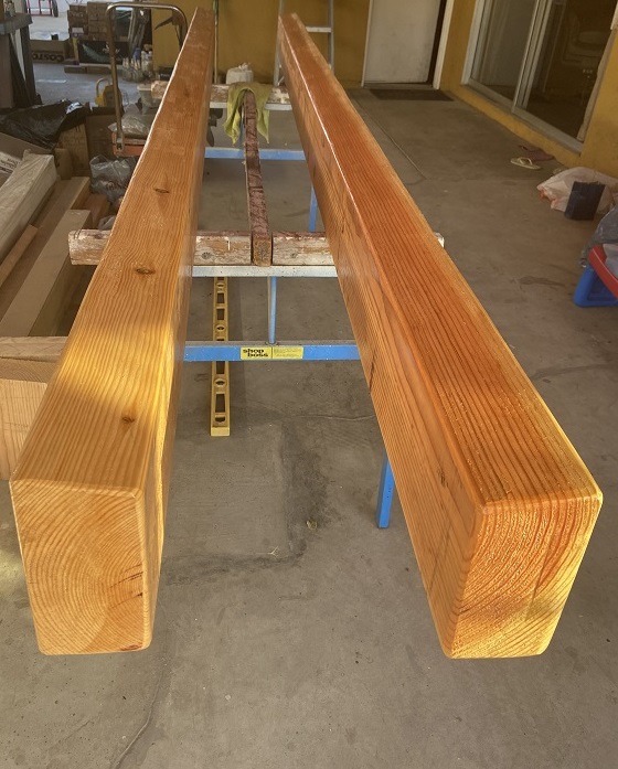

Fig. 4. The wood bunks are cut to an angle to meet flush with the hull.
Fig. 5. Wood given protective coating of polyurethane.
