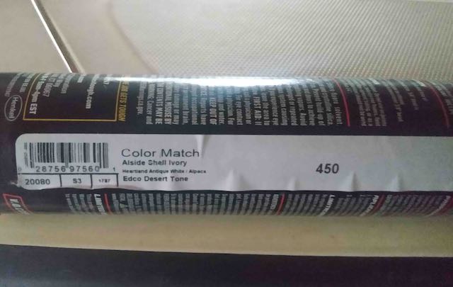

Personally, I went with OSI Quad #450 and am very pleased with it.
While Lowes carries it online, I ordered mine from Amazon.
https://www.amazon.com/OSI-Sealant-10-Fluid-Cartridge-1636981/dp/B013LS91Q6

Re: Caulk for Gunwales/Rub rails
Thanks Phil,
I saw that guys were using OSI Quad #450 on their floor sections such as the fuel tank cover. If I ever have to re-do the floor sections I will defintely use the OSI Quad #450.
I had not seen where anyone used OSI Quad #450 on the gunwales. OSI Quad #450 should work great with fiberglass gunwales . I think white would look better on the varnished teak gunwale to rub rail seam.
I also need a sealant that is fairly easy to remove. I had a heck of a time removing the stainless steel side rail fittings without the 3M 4200 Fast Cure pulling up my clear on the Teak gunwale while removing it. I had one tear in the clear varnish but fortunately it didn't pull it up far enough outside the fitting to see the tear when I get it back together and sealed.
Vance
