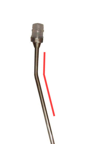

Figure 1 shows the OEM lamp with the [bend in the pole] highlighted
Fig. 1. A pole lamp with a bend whose angle to be determined by readers of this post.
Re: Navigation Pole Lamp Bend Angle
Posted: Tue Jul 05, 2022 1:26 pm
by jimh
I measured the angle of the bend in the image using an image manipulation program and found it to be about 14-degrees, or expressed as the red line is drawn in the illustration, 180 - 14 = 166-degrees

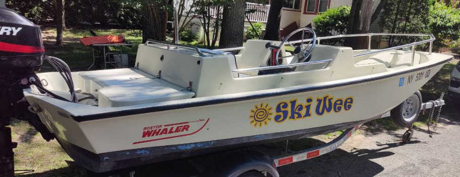

Fig. 2. The particular SUPER SPORT LIMITED 15 that is being discussed in this thread for replacement of a navigation lamp. If you look very carefully a ski pylon can be seen.
ski wee.jpg (47.64 KiB) Viewed 9262 times
I might add a vertical pole to the fiberglass seat back next to the ski pylon. Maybe even something that folds flat that can be out of the way. I am realizing now that where the ski pylon is mounted, having the lamp anchored to the transom might get in the way of the ski rope. This is probably why when I got [this used SUPER SPORT LIMITED 15 boat] there was no [white all-round pole lamp].
There is an electrical connection just below the ski pylon. I could get a lamp that attaches to the ski pylon.

The lamp pictured in Figure 1 has a Fresnel lens. That means it concentrates the light at the horizon. It will be important to get the lamp orientation vertical.
I infer you do not have the original pole lamp and plan to buy one. If you buy a pole lamp for a white all-round light, get one without the Fresnel lens. A lamp like that won't need to be oriented precisely horizontal. I also think a straight pole could be bent as needed with a tubing bender, as long as it was thin-wall steel [that is, to be perfectly explicit and clear, thin-wall stainless steel tubing that you might find used for very light railings or other purposes on a boat and NEVER common contractor supply store thin-wall electrical metallic tubing or EMT conduit].

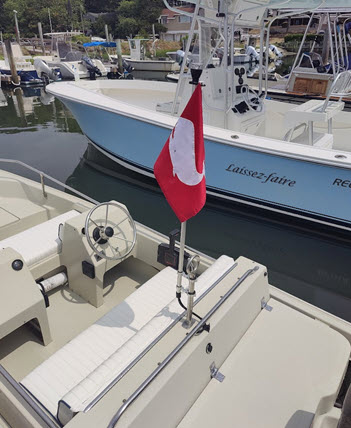

I decided to go with a modestly priced aftermarket articulating lamp on a 36 inch pole. I am going to attach it to the ski eye to make up some height - I came up with a way to do that that should not interfere with the ski eye performance. Will post an update when done.
I am going to attach a flag to it too. My daughters will be using this boat, and I figured having a fag on it will improve visibility. If the pole cannot stand up to the force of the flag, it should be simple enough to replace it with a heavier piece of 316 stainless tube.

This is what I came up with as to not interfere with the ski eye.
Posted: Tue Jul 19, 2022 7:58 am
by Mike Brantley
Mike, please point me to the parts and source for the hardware you used to mount the pole lamp to the ski pylon Thanks.
