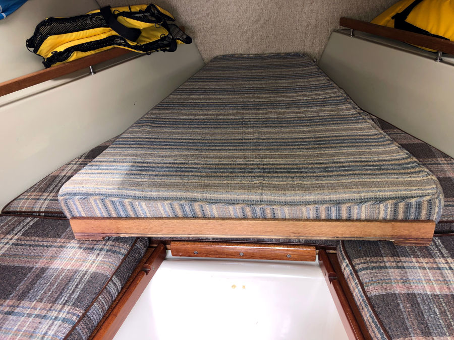

Fig. 1. A new berth filler panel for a REVENGE W-T. This creates a queen-size bunk in the cabin.
As shown in FIgure 1, the new filler panel fills the gap between the original berths and original cushions. Chris was in charge of the mattiress. She found a local source for the foam (at place called "House of Foam"), and had them cut out the foam to the required shape. The shop also did the upholstery, using some fabric they had to upholster the foam. Of course, there was no chance of getting an exact match to the Boston Whaler fabric, but the closest approximation was used, and it has similar colors. Plaid material was very scarce, even back in the early 2000's when this cushion was made, and probably even scarcer today in 2023. The mattress is a nice tight fit into the space between the bunks. As you can almost see, the mattress and panel extend aft to butt against the aft bulkhead of the cabin.
As much as possible, Chris comments, the foam filler piece in the mattress should be matched to the height of the side cushions. Our mattress is just slightly taller than the side cushions. This tends to make a sleeper roll out of the center and onto the side cushions.
After using the bed for some years, we decided the mattress needed to have more foam. A second piece of foam was cut to the shape of the entire larger bed area. This single large piece of foam is just stuffed into a cotton cover for a King-size duvet. The cotton duvet cover becomes the top surface that we actually sleep on. In this way you can take the foam out of the cover, wash the cover, and easily get the foam back into the cover. To store the foam, roll up this big piece of foam and stuff it into a deep rectangular shipping box (that we found somewhere). The extra foam layer is then stored in a bedroom closet.

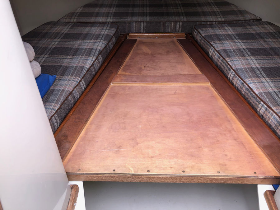

Fig. 2. The filler panel and mattress stowed forward to give access to the cabin.
As shown in Figure 2, there is just enough room in the cabin to move the filler and mattress out of the sleeping position and stow them forward, against the forward bulkhead of the cabin. In actual use, we generally don't keep the filler and mattress onboard unless we are planning to be sleeping on the boat. We store them ashore: the most convenient place we have found to store the filler panel and the mattress is under the queen-size bed in our bedroom. This way we never have to ponder: where did we put that boat mattress and filler?
Figure 2 also shows how the filler panel rests into the space between the bunks. The forward end of filler panel rests on the molded section of the hull liner that is at the top of the foot well. This is the same height that the wooden hatch covers rest at, and they are also made of 1/2-inch plywood. This design makes the base height for all the cushions the same. The aft end also rests on the molded tops of the cabin footwell, but we use a rubber pad as a filler to adjust the height and to avoid scratching the gel coat finish. (The rubber pad was cut from a computer mouse pad--remember those in the days before a laser mouse? )

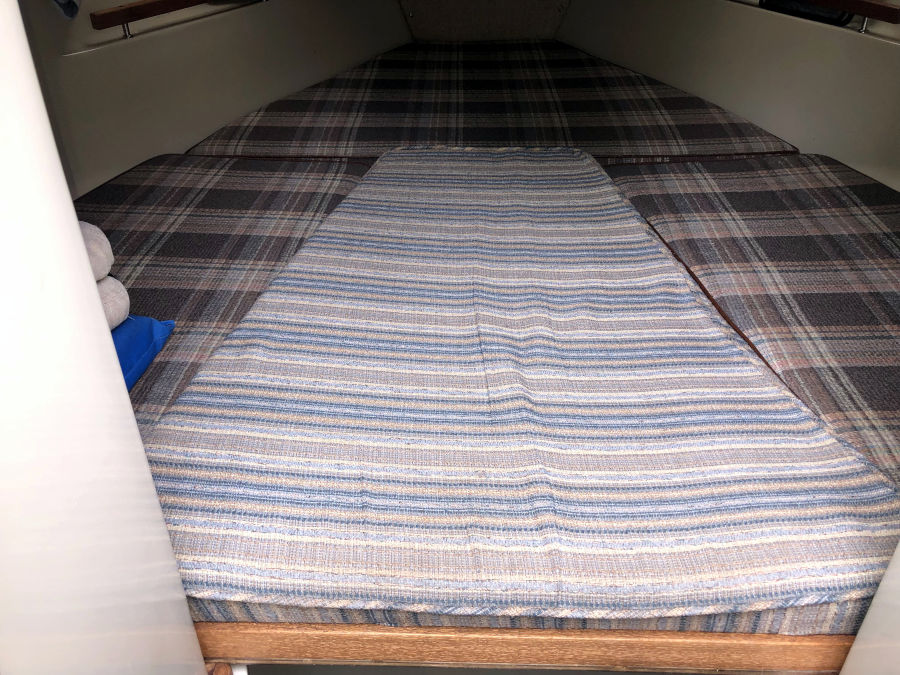

Fig. 3. The filler panel inverted to show the construction of the panel. Because the panel is inverted, the wide end is now resting on the trim piece, so it sitting higher than it would if in the normal position.
As shown in Figure 3, there are three additional pieces of 1/2-inch plywood on the underside of the filler panel so as to be reinforcements. These pieces are all 2-5/8-inch wide. How we picked that number is unknown; it was probably what was left of the plywood after we cut off the main piece.
The two long pieces fit flush with the sides of the filler; they start flush with the aft edge of the filler, and then stop short of the front edge of the filler by 1-7/8-inches.
A third 2-5/8-inch wide piece runs across the panel in roughly the middle, starting 19-inches from the aft edge.
The three plywood reinforcement pieces are glued in place to the main plywood filler panel.
There is a fourth piece of wood that is a part of the filler panel. An oak board (specifically chosen for strength) that is 5/8-inch by 1-5/8-inch is fastened across the top edge of the filler panel along its rear face with eight counter-sunk oval head screw fasteners. This acts as a stiffener to support the long span between the edges of the filler panel. It also acts a a fiddle to keep the mattress from shifting aft on the filler. For added style points, the upper end of the board is symmetrical sawn narrower than the bottom; this gives the board a more finished and yachty look. To keep the mahogany motif, I stained the panel to a suitable brown hue. I was always planning on applying several coats of varnish, but somehow that never gets done
