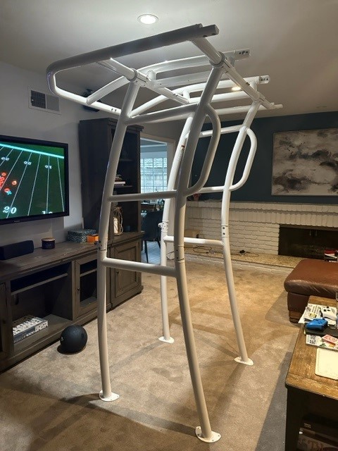

While not a 2016 190 OUTRAGE, I am in the process of installing a Fishmaster T-Top on my 2000 Outrage 18 [note: corrected length from 18-inches; please do not use single quote or double quote marks to indicate length, as these are often confused and used incorrectly, as was done here].
The shipping from the supplier was very quick. Everything appears to be very good quality--for a Made-in-China product.
The weight of the Fishmater T-Top is just over 100-lbs. The T-Top will be situation at more-or-less the center of gravity of the boat. I am not worried about the weight throwing off the design balance--blah, blah, blah. The weight is no greater than a tall and heavy friend standing next to the console.
The front mounting plates will go into the foredeck adjacent to where the center console is fastened down. This is a very solid part of the deck.'''
The rear mounting plates will straddle the area where the aftdeck bolts down; there are long screws that go through the aft deck and into the area of the foredeck where the aft screws down--very solid area. On the bare aft deck section, I am able to get a stainless backing plate under the floor to really reinforce the mounting.
The Fishmaster T-TOP also come with solid standoffs to stabilize the Top to the center console. If you are expecting very rough conditions, you can add optional diagonal supports that go from the T-Top frame to the front of the center console.
The Stryker T-Top seems very similar, but overall I preferred Fishmaster because of the way the Top folds down and free shipping--smongst other things.
I am happy to answer any questions
--Keith

From what is seen in Figure 1, the Fishmaster T-Top is not an all-welded structure. It appears to assemble in parts and bolt together. Such a structure will be less rigid than an all-welded structure, and it will probably have some flex at the bolted joints, if not initially then sometime after it has been subjected to the typical stresses of being on a boat in motion in seas and winds for a while.

jimh wrote:From what is seen in Figure 1, the Fishmaster T-Top is not an all-welded structure.
The Fishmaster and Styker type tops are certainly not all welded construction. They are made in China and shipped in a couple of boxes for assembly at your location. My impression is that the quality is good, but there are compromises over a custom made-to-fit T-top that would cost three or four times more.
jimh wrote:[The fold-down feature] is probably a very good feature if the boat is to be towed on the highway, but on the other hand, in a folded down position, the fixed top will create a much larger wind area exposure, although perhaps mitigated by partially being below the gunwale height and in the less of the center console.
The Fishmaster T-top folds forward at the front leg, then the top section folds in half again. This gets the canvas down low in the boat - well bellow the height of the center console and down bellow the level of the gunwale as you mentioned.
I suppose if I was to trailer my boat a long distance at highway speeds, I could easily fold the top and remove the canvas to eliminate any sail effect and mitigate drag on the structure.
