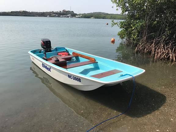

Latest project.
Take a loooong look at that waterline :D

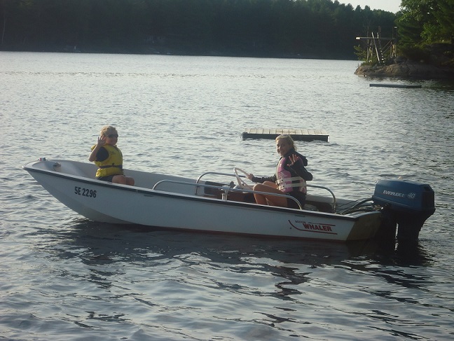

This is how my 1967 13 footer sits with a 1973 Evinrude 50 HP -- around 180-lbs motor. The boat handles best with someone sitting up front. With me alone in the boat, the boat does porpoise at lower speeds.

Whaler at Launch Sm.jpg (246.41 KiB) Viewed 8817 times

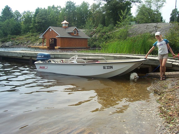

Here is another pic to give you an idea how the boat sits with two aboard.

Summer 2012 SM.jpg (143.96 KiB) Viewed 8817 times
