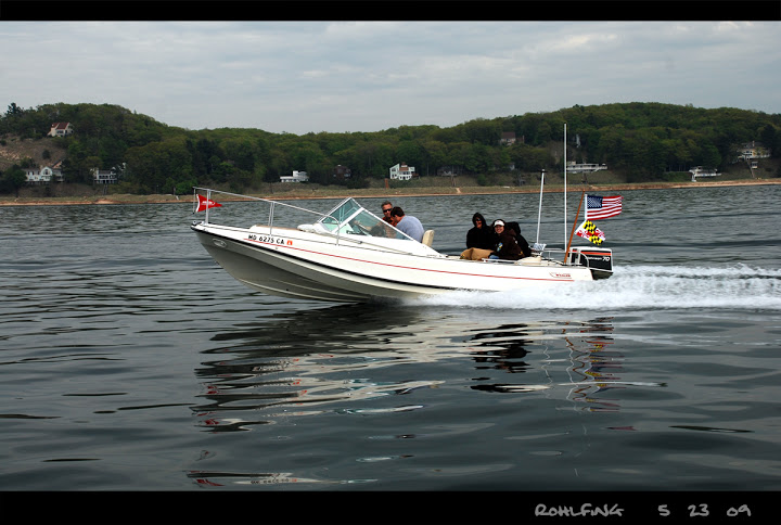

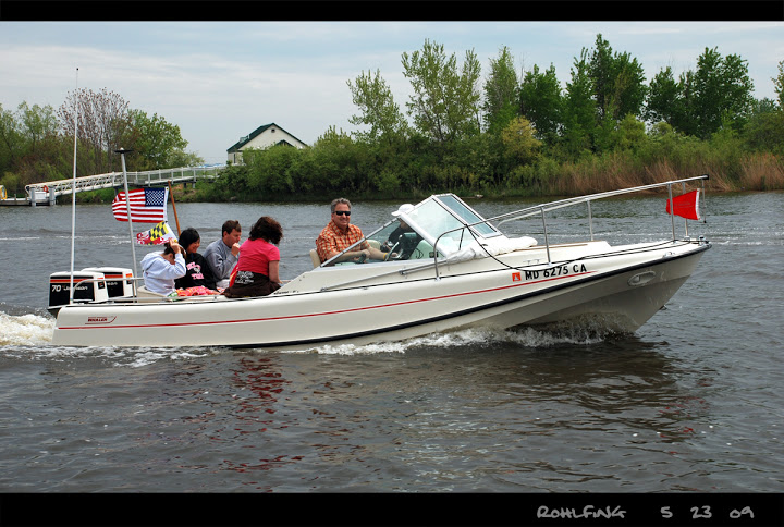

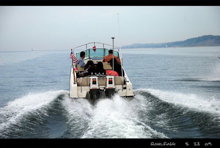

by Jeff
Jim Dunlap (Jimd on the old forum) has a 1976 21 Revenge with twin 1976 70hp Johnsons. Both are standard rotation and he has done a lot of work to settle out the right mounting heights and has done a fair bit of propeller testing. I know he recently settled a set of Stiletto Stainless Props, but I can not find what size and pitch they were.
The boat performs very well with these motors and tops out in the high 30's.

by Driller
That is great, I'll will try to pm him if that's possible to get some advise on engine height and spacing. I think I've seen photos of that boat underway before, very nice, and high 30's would be terrific. I had a Revenge 19 with twin Bearcat 55's on it, that boat also only ran about 25 mph WOT. I felt that the 19 Revenge just didn't have enough deck space for fishing, especially with more than 2 people.
