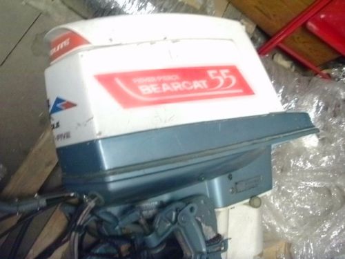

Re: 1988 Montauk Evinrude Re-power
Posted: Wed Feb 17, 2016 10:55 am
by Jefecinco
I like the unusual paint scheme on your engine.
Posted: Wed Feb 17, 2016 8:13 pm
by crbenny
Thanks. That's my attempt at a year-2000 Bearcat. I think it works well with the classic blue and mahogany interior boats. I explained the details not long ago;
