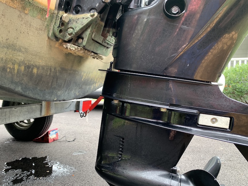

Give me your opinion: is the 2020 Mercury 40 FOURSTROKE engine on my 130 Sport mounted too low?
Fig. 1. Engine mounting height and location of anti-ventilation plate for boat and engine under discussion.

The engine appears to be too low.
The factory is mounting the engine of the current model at "two-holes-up". Another way of saying this: the top bolt in the engine bracket is in the third hole counting down from the top; or there are two empty holes above the bolt.
See the factory drawing here (sheet 2): http://bostonwhaler.com.s3.amazonaws.com/resources/130-Sport-Engine-Installation-and-Parts-List-2006.pdf

Thanks. Yes, the engine is mounted two-holes-up. I wonder if the newer model engine is different from the original. The shaft length [is specified to be the same] but may be different.
Can another participant with a recent re-power comment [about the existence of a significant variable in the actual shaft length among engines specified at a particular shaft length]?

Postby Phil T » Mon Oct 12, 2020 7:31 pm
Measure the anti-ventilation plate. It should be 1-1/2 to 2-inches above the keel.
Yours looks too low.

I would go all the way up which will only bring you about an inch to 1.5" above the keel.
