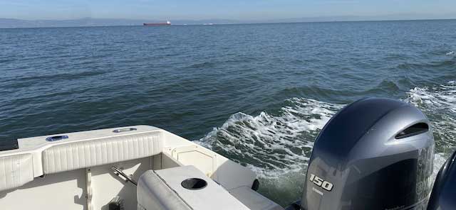

Fig.1. New Yamaha F150 engines installed on 23 CONQUEST

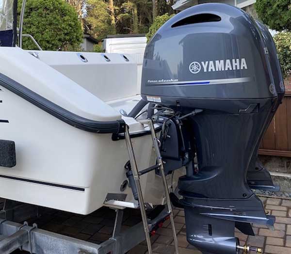

Fig. 2. View from astern.

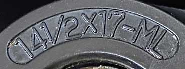

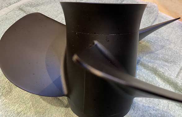

Yamaha three-blade painted aluminum
14-1/2 x 17-pitch

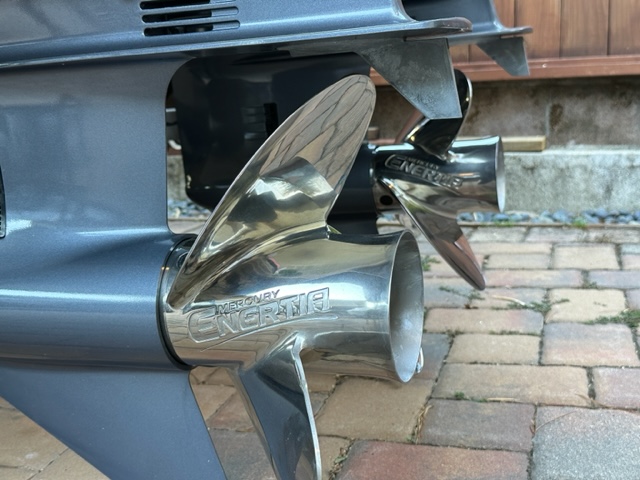

The dealer just gave me a pair of PowerTech stainless steel four-blade OFS4 propellers in 15.25 x 15-pitch. They are heavy and their weight seems comparable to a REVOLUTION4 propeller. I anticipate being able to run a sea trail within two weeks

The SLIP values are not reasonable. A negative value for SLIP indicates the propeller is advancing faster than its pitch allows, which typically means the propeller pitch is understated. Values of SLIP less than 1.0 are also very unusual. These anomalies indicate some problem with the data or with the propeller pitch.
Are you certain the propeller pitch was marked as 17-pitch?
Lower SLIP values may occur with twin engines, but these values seem too low or too negative. Or perhaps the test was done with a favorable current in the water adding several MPH to the boat speed over ground.

Early this week I calculated negative slip too which I could not figure out why. I just looked over my data and notice the 4000rpm was actually 4100rpm. MPH and RPM at WOT are accurate.
The location of the test was South San Francisco Bay where there isn't a lot of current. We were in the shallows so current should be no more than 1mph. Winds were very clam. In my opinion, conditions were pretty ideal for the test.
Fig. 5. The Yamaha aluminum three-blade propellers are marked 14-1/2 x 17-pitch.
Fig. 6. There seems to be a little [blade] cupping.
Blade cupping might be a contributing factor to the propeller's effective pitch.
The propeller Yamaha part numbers are 6G5-45947-01 and 6K1-45947-00.

Referring to the Yamaha aluminum three-blade propellers:
ivansfo wrote:There seems to be a little cupping
If there is blade cupping, it is very difficult to see any blade cup illustrated in Fig. 6.
ivansfo wrote:Blade cupping might be a contributing factor to the propeller's effective pitch.
Blade cupping always tends to increase the propeller's effective pitch.

I want to update and close out this thread. I have been focused on fishing and just getting acquainted with the new twin Yamaha F150 engines paired with Yamaha 3-bladed aluminum propellers. The 3-blade aluminum propellers run well, but I have been seeking to try the Mercury ENERTIA propeller. After over a year of searching, I finally assembled a clean pair of Mercury ENERTIA 14.5-inch x 17-pitch propellers--the identical size to the Yamaha propellers I have been using.
On October 14-15, 2023, I tested the ENERTIA propellers in San Francisco Bay. I feel the performance of the ENERTIA propeller is nearly identical to the Yamaha aluminum propellers. One notable improvment with the ENERTIA propellers is the lack of shifting clunk, which I attribute to use of the Mercury SSR dampening hub.
Testing was performed in the same manner as with the Yamaha three-bladed aluminum propellers, but this time with an extra 830-lbs of gear aboard.
I plant to keep the ENERTIA propellers on the boat to see how they perform in various ocean conditions.

Because of the added 830-lbs in the testing of the ENERTIA propellers, comparing the results of the two tests is difficult. Adding that much additional weight is certain to reduce the boat speed, and, indeed we see that in the test data:
TOP BOAT SPEED
Mercury ENERTIA = 47.4-MPH
Yamaha Aluminum = 49.2-MPH
This is essentially the opposite outcome that most would expect, that is, the ENERTIA propellers, being stainless steel, being made from Unobtainium X7 alloy, and being noted for their ability to increase top speed, should have demonstrated a boat speed increase. But the opposite outcome is explained by the extra weight. Even though a 23 CONQUEST is not a lightweight boat, adding 830-lbs is certain to have decreased the top boat speed the twin 150-HP engines could deliver.
Other influences can affect the engine power output, such as air temperature and humidity. Water temperature can also affect propeller performance. For these reasons, comparison testing should be done with as much similarity as possible.
