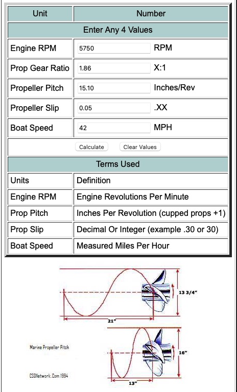

With an engine/hull combination such as that I do not have any owner recommendations on prop selection.
In computing pitch using a prop calculator, it returns a recommendation of 15" of pitch (see below).
As for prop make/model, I would defer to prop guru.
Given you are in France, I would ask prop sellers if they allow testing and returning props. If they say yes, start with a stern lifting 3 bladed stainless steel model with 15" of pitch. You may need to test several props.
- pitch.jpg (110.42 KiB) Viewed 6078 times
