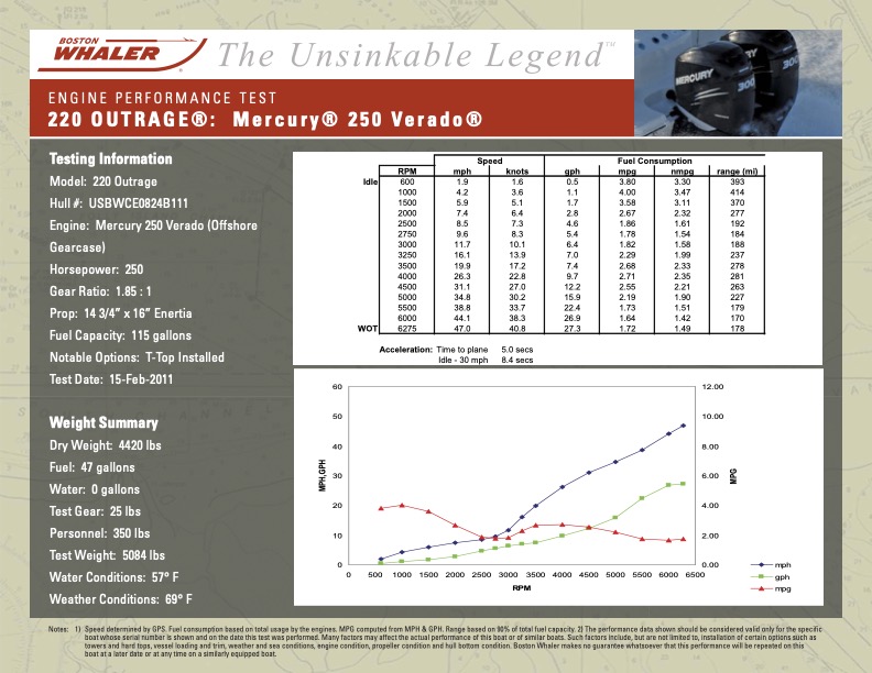

Attached below is the factory performance report for your boat.
While the factory shows a WOT of 47, I would deduct 3 mph for bottom paint. While their testing is somewhat ideal, still leaves you 9 mph too low.
Your test data shows engine speed is 600-RPM low. On a Verado that is were the real speed is generated.

Interpolating the Boston Whaler performance data, their test boat was able to reach 40.3-MPH when the engine accelerated to 5,650-RPM.
In other words, if we assume your measured speeds were in nautical-miles-per-hour, your reported boat speed is identical to the Boston Whaler reported boat speed at an engine speed of 5,650-RPM.
Please confirm the unit of speed you are using for the boat speed data.
I also notice that in your test report of the single data point for boat speed and engine speed at maximum throttle, you mention that the engine trim is configured to suppress bow oscillation. From that comment I infer the engine trim was set to hold down the bow. This trim setting may also be a factor in limiting the engine speed to only 5,650-RPM.
If you look at the graph on the Boston Whaler test report, you see that the slope of the curve of boat speed as a function of engine speed begins to have a faster rise once the boat speed gets over 40-MPH. This faster increase in boat speed with engine speed occurs because as the boat speed increases the hull wetted surface will decrease. There is less hull in the water so there is less drag. As PHIL mentioned earlier, often the last few MPH of top speed occurs in the very last few hundred RPM of engine speed.

Regarding the performance of the two boats under discussion, first the Boston Whaler boat in the Boston Whaler test report, and the second the 2011 220 OUTRAGE owned by the initiator of this discussion, the two boats have the same engine and propeller.
The propeller is the ENERTIA propeller from Mercury. It seems the raison d'etre for selecting an ENERTIA is to extract a boat speed increase at engine full-throttle compared to a more conventional propeller. (The comparison propeller used in much of Mercury's promotional literature was the very highly regarded MIRAGEplus three-blade propeller.)
The ENERTIA propeller is made from an unusual alloy of stainless steel that is noted as permitting the propeller blades to be cast thinner than other stainless steel alloys used in other propellers would allow. The characteristic the ensues from thinner propeller blades is assumed to be an ability to be turned in the water more easily.
The reports from comparisons of ENERTIA propellers to other similar stainless steel propellers of the same marked pitch is the engine will be able to turn the propeller at a higher speed, while the propeller will provide the same efficiency at producing thrust. The typical report about ENERTIA propellers is they allowed a particular engine on a particular boat to produced a higher boat speed by a margin of 2 to 3-MPH when at the very maximum engine speeds permitted. Because this difference occurs only at the engine's maximum permitted engine speed, Mercury makes the ENERTIA in pitch increments of only one-inch to permit very fine tuning of the propeller load so as to let the engine accelerate to its very highest allowed speed but not over.
The analysis of the cause of the difference between the factory boat speed at WOT and the customer's boat speed at WOT really comes down to the difference in engine speed. If the customer's boat is going to match the factory's boat in WOT boat speed, the VERADO must be able to accelerate to the same very high engine speed in both boats, to 6,275-RPM. The customer's VERADO engine tops out at 5,650-RPM, or 625-RPM slower.

Below I have calculated the SLIP value for some of the performance data mentioned in this discussion.
For the factory test data:
--WOT at 6275-RPM and 47-MPH boat speed, SLIP= 8.5. This is an entirely reasonable and expected value.
--my interpolated test data for that boat at 5650 RPM and 40.3-MPH, SLIP = 12.9. This is also a entirely reasonable and expected value.
For the customer's boat from customer's test data:
--WOT at 5650 and 35-MPH boat speed, SLIP = 24.2. This value is far out of expected range.
For the customer's boat with customer's test data ("35") interpreted as nautical-miles-per-hour
--WOT at 5650 and 35-nautical-miles-per-hour boat speed, SLIP = 12.9. This value matches exactly with the factory test report data.
Based on this analysis, if the customer's test data was reported in nautical-miles-per-hour, the propeller performance looks normal; the engine is just not making power.
If the the customer's test data was actual miles-per-hour, the propeller performance is not normal, but the engine is still 625-RPM below its expected engine speed at WOT.
Has the mystery been solved?

When collecting performance data, recording the engine speed and boat speed at different throttle settings is recommended over just one data point at full-throttle. When you plot the data on a graph showing boat speed as a function of engine speed, trends can be better seen.
That you contacted Mercury customer support and they expresses interest in solving your problem is a good step towards a solution.

Mercury said to plot boat speed from 2000 RPM to WOT in 50 RPM increments. They also want pictures of the engine and transom.
I actually spoke face to face with a Mercury rep at a boat show over the weekend. He was most helpful and interested to resolve the boat speed deficiency on my boat.
Re: 2011 220 Outrage 250-HP VERADO
Posted: Tue Jan 18, 2022 5:47 pm
by jimh
You must mean 500-RPM increments. If Mercury told you to test in 50-RPM increments they were sending you on a wild goose chase.

I have a 2011 220 Outrage with 250 Verado, and its top boat speed is 44-MPH. The 220 OUTRAGE hull has bottom paint.
Initially we trimmed the VERADO 250 engine to level "7" on the Smartcraft gauge to allow the engine to accelerate to 6,300-RPM and produce a boat speed of 42.5-MPH.
In 2021 the engine was raised two-holes; now the maximum trim level is "5", and the engine accelerates to the same 6,300-RPM as before but the boat speed is now 44-MPH [an increase in top boat speed of 1.5-MPH].
Q16: what is the engine idle speed of the VERADO 250 on the boat under discussion?

Hesnothere wrote:...I plan to compile data on performance of the 220 Outrage with various engines, propellers, loads, options, and model years.
A month has passed since you announced your plan to collect data on the performance of the 220 OUTRAGE boat with various engine, propellers, options, and model years.
Q17: have you made any progress on this project?
Also, regarding collecting performance data, on your own boat you have published only ONE performance datum, the engine speed and boat speed at full-throttle. Perhaps as a start to your collection you could publish more comprehensive data on the performance of your own boat. A report similar to the Boston Whaler factory performance report with information on fuel flow rate, engine speed, and boat speed at many throttle settings would be a good place to start.

With a new propeller, the 250-HP VERADO] engine was [tested again and was found to be able to accelerate to] 150-RPM [higher maximum speed].
When I have chance to run an on-water performance test again in a few weeks and log some numbers, I will post them.
About the engine height: I agree [with whatever was said about the mounting height]. I’ve been looking at [engine mounting height].
I made a recording of the engine when running the older propeller. The recording shows the anti-ventilation plate.
I think [the engine mounting height is] too low, even though the mounting height is set to factory specs.
Also, [the boat tends to] list to Port--which I think is caused by propeller torque.
I think [the tendency for the boat to list to Port] can be improved by raising the engine.

Torque steer is a thing but let's not get distracted.
Performance testing needs to be controlled and methodical. You want to keep all the variables fixed and only change one at a time.
For example:
Replace prop
Test (standard load, fuel, typical weather)
Analyze results.
Raise engine.
Retest using same load, weather as above)
Analyze results.
Change engine trim tab
Retest.
Don't change two variables at one time.

My Boston Whaler boat always tends to lean into any crosswind. My Boston Whaler boat is powered by a single standard-rotation engine of 225-HP. I have tested over a dozen propellers, and I have never noticed that a particular propeller was causing a tendency to lean to port.
I don't notice a pronounced tendency for the boat to always lean to Port when underway at higher engine power. The boat routinely exhibits a slight tendency to lean into a crosswind, and this is easily corrected by a slight shift in the position of the helmsman in the direction opposite to the leaning direction.

Hesnothere wrote:...With a new propeller....
Without knowing anything about the new propeller, such as its make, model, and dimensions, a report that the new propeller affected maximum engine speed is difficult to interpret. Please give readers the make model and dimensions of "the new propeller."
Hesnothere wrote:About the engine height: I agree....
Please be more specific about what you are in agreement with that was said previously. Otherwise readers will have to re-read the entire thread in order to attempt to figure out what statements you are agreeing with.
