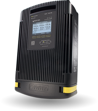

The P12 Battery Charger from Blue Sea Systems may be the ultimate 120-Volt AC-operated 12-Volt-DC marine battery charger. The P12 can individually re-charge three 12-Volt batteries of similar type, providing a maximum total output current of 25-Amperes or 40-Amperes depending on model. The P12 Battery Charger has several unusual features.
The battery charging method is described as a four-stage process. The four stages of charging are called:
--bulk, when the full-output of the charger is pushing as much current as it can into the battery, until the battery reaches a state of charge of about 75 to 80-percent;
--absorption, when the charger begins to taper off its charging current, as charging continues to 100-percent;
--pre-float, a new stage unique to this charger, in which an intermediate voltage, higher than the float voltage but lower than the absorption voltage, is applied to one or two of the attached batteries while the third battery remains in the absorption stage; and,
--float, when a carefully regulated voltage is maintained to keep all three fully-charged battery at maximum charge.
The voltages during these stages are also compensated for temperature. If the battery temperature is cold the voltages for charging are increased somewhat, and if the battery is a warm the voltages are decreased. Temperature compensation of this type is typically recommended by battery manufacturers to get the best possible charging of their batteries.
In addition, the P12 charger contains four pre-set profiles for charging voltages in the four-stage process, with provisions for batteries of various constructions:
--flooded lead-acid
--gelled electrolyte lead-acid
--absorbed glass mat or starved electrolyte lead-acid, and
--thin-plate pure-lead lead-acid (see more on this below in follow up article)
If none of the pre-set profiles are suitable, the user can create his own custom charging profile to match the recommended voltages for charging a battery as provided by the battery manufacturer.
The P12 can also interface with Blue Sea Systems automatic charging relay (ACR) devices to insure that all batteries are isolated during charging. It does this by preventing any of the ACR devices from paralleling a battery with another during charging using the feature called Start Isolation in the ACR devices.
The P12 Battery Charger has a large display screen to provide status information, offer diagnostic messages, and to permit user programming of the charger operation, such as the individual charging profiles for each battery. If access to the main display is not convenient, there is an optional accessory, the P12 Battery Charger Remote, that allows for a second and somewhat simplified status display and some limited control functions to be provided at a location remote from the actual charger. A 25-foot interconnection cable is provided; cables as long as 150-feet can be used.
All these features come at a price: the P12 Battery Charger has an MSRP of $550 for the 25-Ampere model and $700 for the 40-Ampere model. It is also a rather massive device, with a housing of about 13 x 9 x 4-inches and weighing 13-lbs. The model 7520 remote display and control has an MSRP of $120.
If your boat spends lots of time at a dock and connected to shore power, the P12 Battery Charger is probably one of the best solutions for providing proper battery charging and care.
Blue Sea Systems P12 Battery Charger

In the four stages of the Blue Sea Systems P12 Battery Charger, the output is only voltage regulated in three of the stages:
--BULK: apparently no voltage regulation used here as the charger is trying to push as much current into the battery as the battery can accept and as the charger can supply; this is called a constant-current stage; this stage continues until the battery terminal voltage rises to the absorption state voltage;
--ABSORPTION: the charger output is regulated to the proper voltage as determined by profile selection, and charging continues but at a lower current; the charger remains in this stage until several parameters are satisfied, including a time duration parameter and the amount of current flowing; these parameters are called ABSORB TIME and END ABSORB AMPS. The time can be varied from one to five hours. The END ABSORB AMPS is typically set to be about one-percent of the battery's Ampere-hour capacity. For example, if you have a 70-Ampere-hour battery, the current to trigger end of ABSORPTION mode would be 0.7-Ampere. If there are any static loads on the battery, the END ABSORB AMPS should be modified to account for that additional current flow in the circuit. The instructions recommend setting the time and current parameters based on actual measurements of the particular batteries in use as they are being charged by the P12 charger.
--PRE-FLOAT: the charger output is regulated about 0.5-Volt lower than the absorption state;
--FLOAT: the charger output is regulated to the manufacturer's recommended float voltage for the battery type;
There are four profiles preset and a fifth profile may be customer defined. Here are the voltage settings:
PROFILE                    VOLTAGE
NAME ABSORPTION FLOAT
Flooded Lead Acid 14.5 13.5
Absorbed Glass Mat 14.35 13.3
Gelled Electrolyte 14.1 13.5
Thin Plate Pure Lead 14.7 13.6
User Adjustable 12.5 12.5 (Default settings)
The User-Adjustable profile can be set to user-defined voltage points for absorption and float. The TPPL voltages are taken from the Odyssey and Northstar battery literature. The voltages are based on temperature being 77-degrees-F.
Also note that the selection of a profile setting adjusts ALL outputs to that setting, so the charger should not be used to charge a mix of different battery types; all three batteries being charged should be the same type. The instructions contain several warnings advising not to mix battery types.
The design of this charger and the many parameters in the charging process that can be adjusted are worthy of the description I have used: the ultimate battery charger.
The concept of a battery charger having different modes of charging and changing among those modes as the battery responds to the charging current is nothing unusual or particularly excessively complicated in modern battery management. Particularly useful in the P12 chargers is the provision for several presets and the ability to adjust those parameters to suit a particular battery's behavior. With modern batteries costing as much as $400 each, it seems prudent to use battery management methods that extend their useful service life and provide the best energy storage. To use a $550 charger to maintain a three-battery bank of $400 batteries is not excessive; it is the same investment as using a $45 charger to maintain a $100 battery. (For example, the Firefly Lead-Acid Carbon Foam Group 31 battery is $486. Would you charge this with a $40 Walmart charger?) By using better charging techniques, a P12 charger would easily extend the service life of the batteries significantly, and pay for itself in saved battery replacement costs. Using a "simple" charger which does not provide good battery management could easily significantly reduce the useful service life of a battery and lead to higher overall battery costs.
