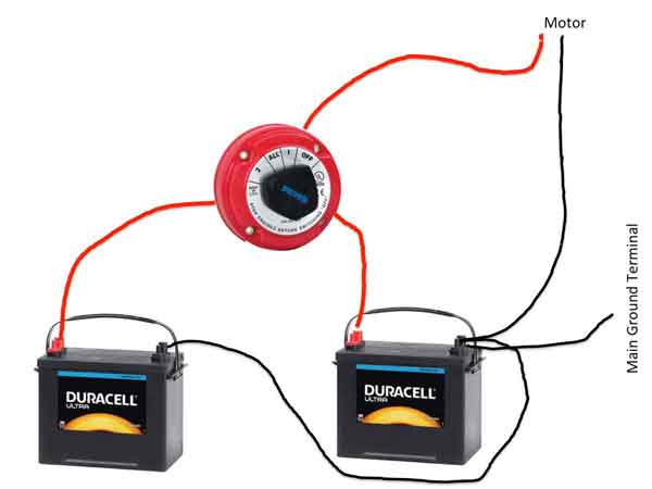

Here is simple diagram.
I realize both batteries can not be charged at the same time. Switch says I can with from A to B but not to off while motor running.--M

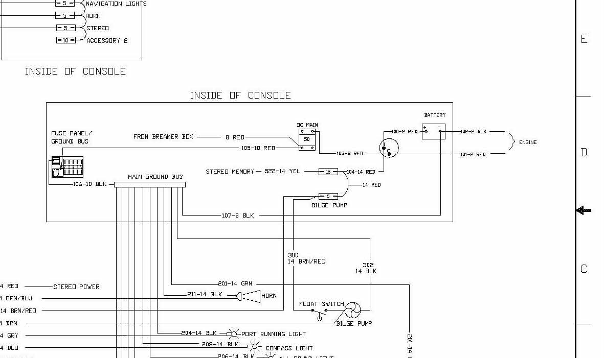

Based on the factory wiring diagram for a single battery, it appears that the 12-Volt negative bus (which is called MAIN GROUND BUS in the drawing) will not carry any engine starting current. The 8-AWG conductor is insufficient to carry engine starting current, and it is also likely the size the negative bus is not appropriate to carry engine starting current.
Since you want to have two batteries available for engine starting, you MUST connect the negative terminals of the two batteries in common with a conductor that can carry the engine starting current. That conductor should be 2-AWG, based on the factory drawing showing that the cables carrying battery power to the engine are 2-AWG.
You won't have a real primary 12-Volt negative bus; the battery terminals themselves, connected together with a 2-AWG conductor, will serve as the primary 12-Volt negative bus. The 8-AWG conductor from one of the battery terminals to the bus marked in the drawing asMAIN GROUND BUS will bond that bus, now really the secondary 12-Volt negative bus, to the primary 12-Volt bus (the battery terminals).
Or, if you want--although not mandatory to have--you could install a new, much larger capacity, bus. To the new bus, which will be then the primary 12-Volt negative bus, you will connect the engine negative cable, the negative terminal of all batteries in the 12-Volt system, and the 8-AWG feed to the secondary bus (that is called MAIN GROUND BUS in the drawing). That is exactly what I drew in my sketch.

InVision wrote:Here is simple diagram
Your pictorial sketch shows what I described in my narrative and schematic diagram; the negative terminals of the battery are bonded together. Use 2-AWG for that connection.
InVision wrote:I realize both batteries can not be charged at the same time.
No, that is not the case. If the switch is in the BOTH position, and if the engine is running, the charging current from the engine will be shared between the two batteries.
InVision wrote:Switch says I can with from A to B but not to off while motor running.
Actually, what the switch says can be seen in the drawing; the switch says: STOP ENGINES BEFORE SWITCHING "OFF'"
Perhaps you meant to say that you must not move the switch to OFF while the engine is running, but can move it from 1 to ALL to 2 or back.
In order to be able to move the switch among 1, ALL, and 2 positions and have the engine running, the switch must be a make-before-break action. I recommend you check the switch action with a continuity tester to verify that the switch you have actually has make-before-break action.

Getting back to my earlier comments about the difference between ground and negative circuits, if you look closely at the whole wiring diagram for the Boston Whaler 2004 190 NANTUCKET, you will see precisely what I showed in my sketch. There are several conductors in a BONDING system which tie together elements of the FUEL SYSTEM. In the Boston Whaler PDF file (see below for link), you can clearly see these conductors. They are identified as having GREEN insulation, associated with ground. They connect to the same elements as I diagramed in my sketch: the fuel tank and the filler. This circuitry appears in the drawing sector 2-A (lower right). (The wires in close proximity with PINK insulation are associated with the fuel tank resistive level sender, not the bonding circuit, and carry the fuel tank level sender signal to the tank level gauge display devices.)
As I mentioned earlier, if the boat does not have a dedicated submerged grounding electrode, the bonding system is then tied to the 12-Volt battery negative bus, and, indeed, that is exactly what occurs in the Boston Whaler 190 NANTUCKET drawing.
The confusion arises because in the factory's drawing they refer to the 12-Volt negative bus as MAIN GROUND BUS. The bus is really the 12-Volt negative bus for the HOUSE loads, and the bonding system is tied to it. The attachment to the sea occurs via the outboard engine. The negative circuit of the 12-Volt system going to the outboard engine is bonded to the powerhead of the engine. Other metallic components of the engine with exposed metal surfaces like the sacrificial anodes are in contact with the seawater. They provide the link of the boat's 12-Volt negative circuit to the "ground" or in this case the sea.

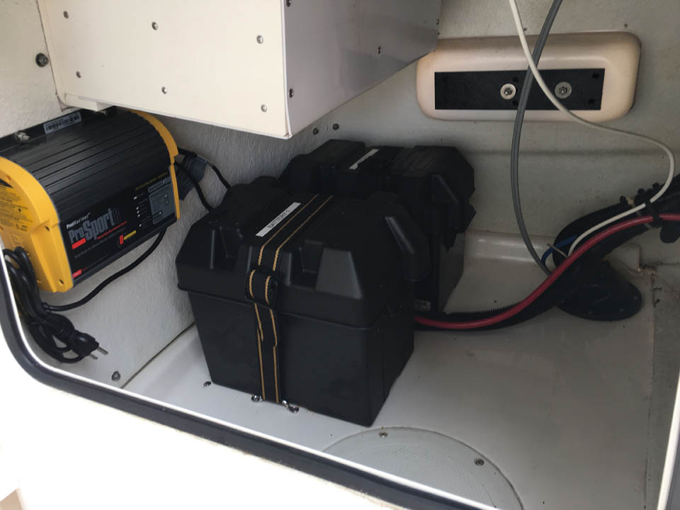

If did not already have an extra charger left over from the SeaRay I would be considering the Blue Sea Systems 7605. I am going to install just the basic system for now. Battery, battery box, 2-AWG wire, and Perko switch were only $140.
I am not sure how to get 120-V AC dock power into the console without cutting a hole for cord or mount a connector.
Re: Dual Battery Setup on 2004 Nantucket 190
Posted: Fri Sep 08, 2017 4:18 pm
by InVision
Well it is done. Basic dual battery and charger/maintainer for dock boat lift. Thank you for all the replies.
Posted: Sat Sep 09, 2017 12:13 am
by jimh
You did a nice job on the installation. Good work.
