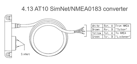

The AT10 cable has the following connections:
AT10 Cable.PNG (32.79 KiB) Viewed 26842 times

If indeed the Calypso device will output NMEA-0183 sentence MWV then connecting to another NMEA-0183 device ought to be straightforward.
The signal that Calypso calls "Data A" is better named TALKER A. I don't know the wire insulation color.
The signal that Calyypso calls "Data B" is better named TALKER B. I don't know the wire insulation color.
To interface to NMEA-0183 you connect TALKER A to LISTENER A and TALKER B to LISTENER B.
On the SIMNET device, based on the legend in the illustration above, the input signals are
LISTENER A = WHITE
LISTENER B = BROWN
This wire insulation scheme is actually backwards, as normally in proper NMEA-0183 wire insulation colors WHITE and BROWN are TALKER A and TALKER B, but I suspect that SIMRAD did this intentionally so that when interfacing their device to a NMEA-0183 device the wires could be connect to color-on-color, making the interconnection simpler, perhaps in the minds of the SIMRAD engineers.

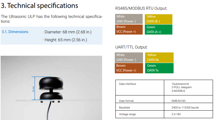

A page from the Calypso manual:
Calypso Data.PNG (71.83 KiB) Viewed 26823 times

From the illustration above, the NMEA-0183 output appears to be
TALKER A = GREEN (inferred from "Data +")
TALKER B = YELLOW (inferred from "Data -")
Note: that is completely backwards from the normal wire insulation color coding.
What is not clear to me: How do you set the output mode?
Apparently you have to make a receive and transmit connection using RS-232. In RS-232 mode the NMEA-0183 signal names would then be
TALKER A = GREEN
TAKER B = not provided
LISTENER A = YELLOW
LISTENER B = not provided
To interface when the device is in RS-232 mode, the connections would then be:
TALKER A = GREEN ---> LISTENER A
Ground = WHITE -----> LISTENER B

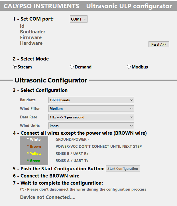

The Calypso is configured using what they call their "Configurator", a program I downloaded to my laptop, and then over that same RS485/USB converter connection, I set up the anemometer. Here is a screenshot of the "Configurator" so you can see what the options are:
Cconfigurator Screen.PNG (31.65 KiB) Viewed 26798 times
I set it at 4800 and "Stream" mode...I don't know if that was correct and the Calypso support people didn't seem to know what should be used for a boat! If you look at their website, they promote the use of the anemometer for many different applications.
