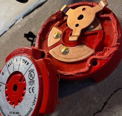

The bad news for me: the old switch felt, sounded, and measured all good when I turn it. I did take apart, I had to basically destroy it to open it, and its contacts look very clean.
The old switch measured 0.6 to 0.7 Ohms, which I believe is normal for continuity for a switch.
Fig. 1. The battery switch rear panel. [Presumably, this is old switch whose function was suspected to be the cause of the intermittent electrical system drop out.]
Fig. 2. The old battery switch after disassembly to reveal the condition of the contacts inside.

islavov wrote:The old switch measured 0.6 to 0.7 Ohms, which I believe is normal for continuity for a switch.
Measuring very low values of resistance can be a difficult, and often to get a really accurate measurement a rather precision meter and measuring technique is needed. However, that said, I think the resistance values you give are rather high.
The engine's cranking motor will probably draw over 100-Amperes at start and during cranking probably maintain about 100-Amperes.
The voltage drop that will occur when 100-Amperes flows across a 0.7-Ohm resistance will be 70-Volts. That could never happen in a system operating from a 12-Volt battery. With 0.7-Ohms in the switch, the most current that could flow with 12-Volts would be 17-Amperes, and that is not going to let the cranking motor turn over.

PHIL T makes a good point. Buying the no-brand cheapest stuff may not pay off in the long run. A good vendor to use for marine surface mount circuit breakers is Blue Sea Systems and their 285-series, which sell for about $40 on Amazon. See the manufacturer's listing of circuit breakers for surface mounting at
https://www.bluesea.com/products/catego ... face_Mount
and see Amazon vendors of them at
https://www.amazon.com/Blue-Sea-Systems ... V7AA/?th=1
