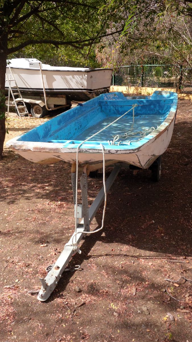

So my dad and I bought a boat
Postby Albert Jr. » Thu Jun 23, 2016 7:07 pm
This all started when a customer came in with a 40 hp Tohatsu. We finally gave in and decided to buy it. After a while another customer of ours gave us a lead for a Boston Whaler 13 and we bought it also after some negotiating. The boat is from 1970 and is in decent shape (foam is solid). We've sandblasted it and we hope to have it ready for paint by the end of this month.

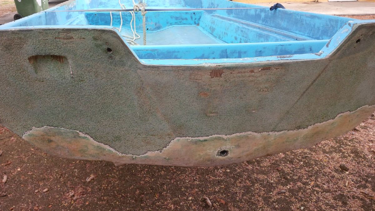

Postby Albert Jr. » Thu Jun 23, 2016 7:28 pm

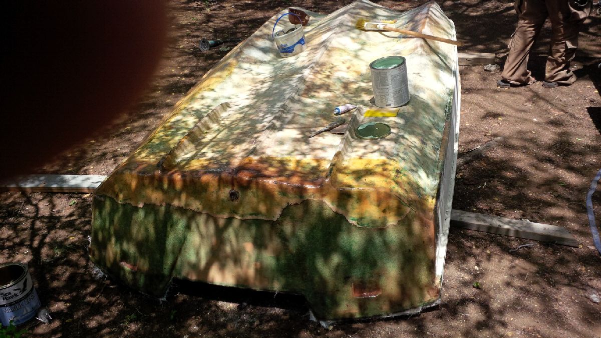

The day we got her back from sandblasting, we could see a bit better how much work the hull needed. It's going to be a job but I've seen worse.

After glassing we've started adding a marine body filler called Power Grip. It's softer than usual fillers which makes it easier to grind. We will add one or two more layers before painting.
Albert Jr.
Posts: 53
Joined: Wed Oct 28, 2015 4:26 pm
Re: So my dad and I bought a boat
Postby Albert Jr. » Sun Aug 07, 2016 8:40 am
We finished off the fairing starting with p60 grit paper, then p140 grit paper, and then ending with p220 grit paper. The fairing has been going well, so far. Only problem we've seen is that the body filler formed some notches. We wanted to fix this by using Total Boat primer, which the paint company said can fix notches.

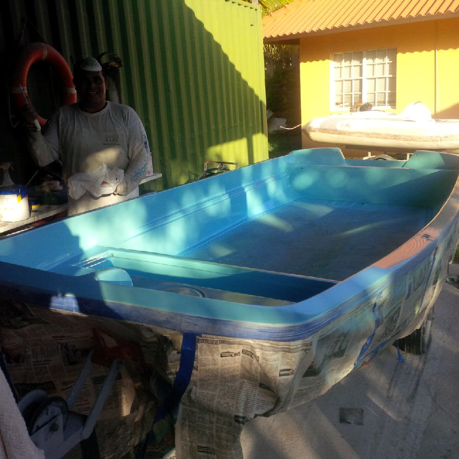

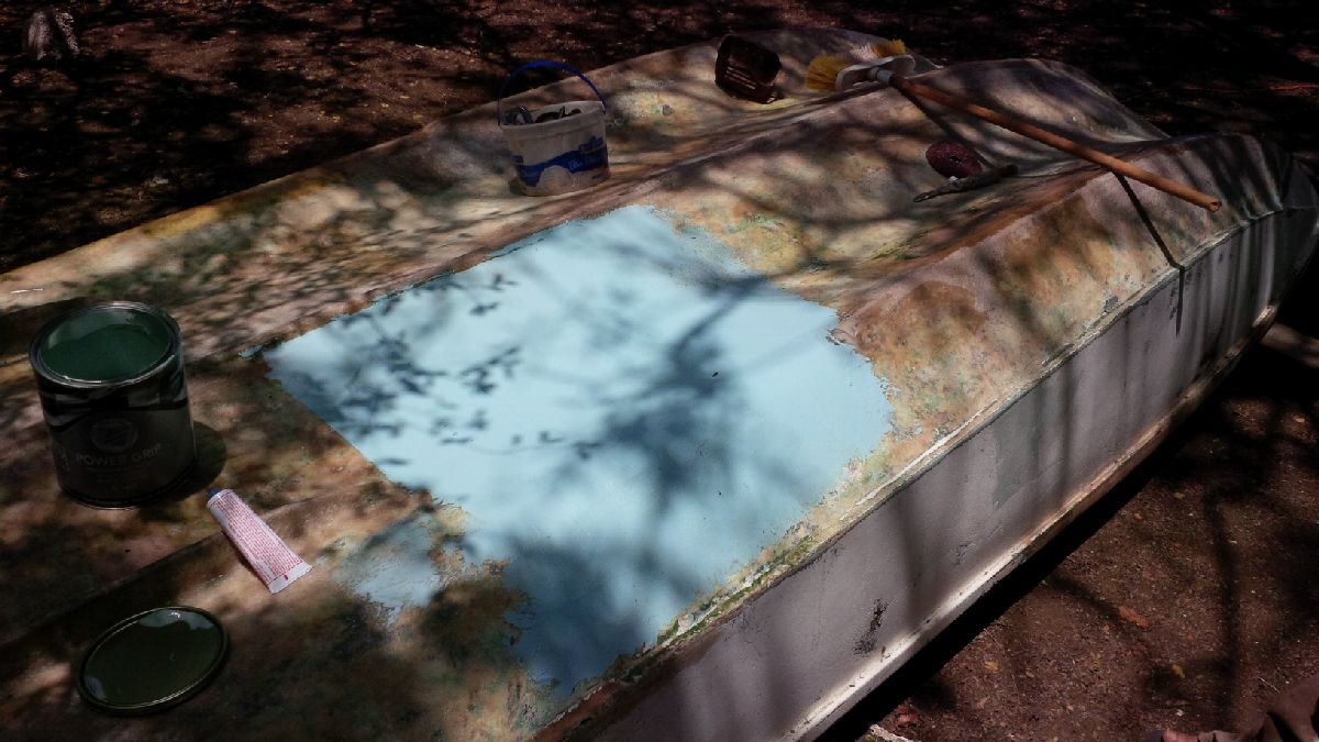

Postby Albert Jr. » Sun Aug 07, 2016 8:45 am
Being a brush-on primer and quite thick, we decided to use a thinner to make it possible to spray on. This made for some small holes.
Albert Jr.
Posts: 53
Postby Albert Jr. » Sun Aug 07, 2016 8:47 am
To counter the small holes that resulted from using a thinned primer and spraying it on, we tried rolling on the primer. It helped fill the holes. We sanded the primer and added a light primer.
Albert Jr.
Posts: 53
Postby Albert Jr. » Sun Aug 07, 2016 8:52 am
After the second primer, there were some minor detail that our fiberglass specialist wanted to fix. Those repairs took some extra time, but we managed to get the bottom painted using Total Boat white paint. It's looking great. All the boat needs now is a nice polishing job before we flip her.

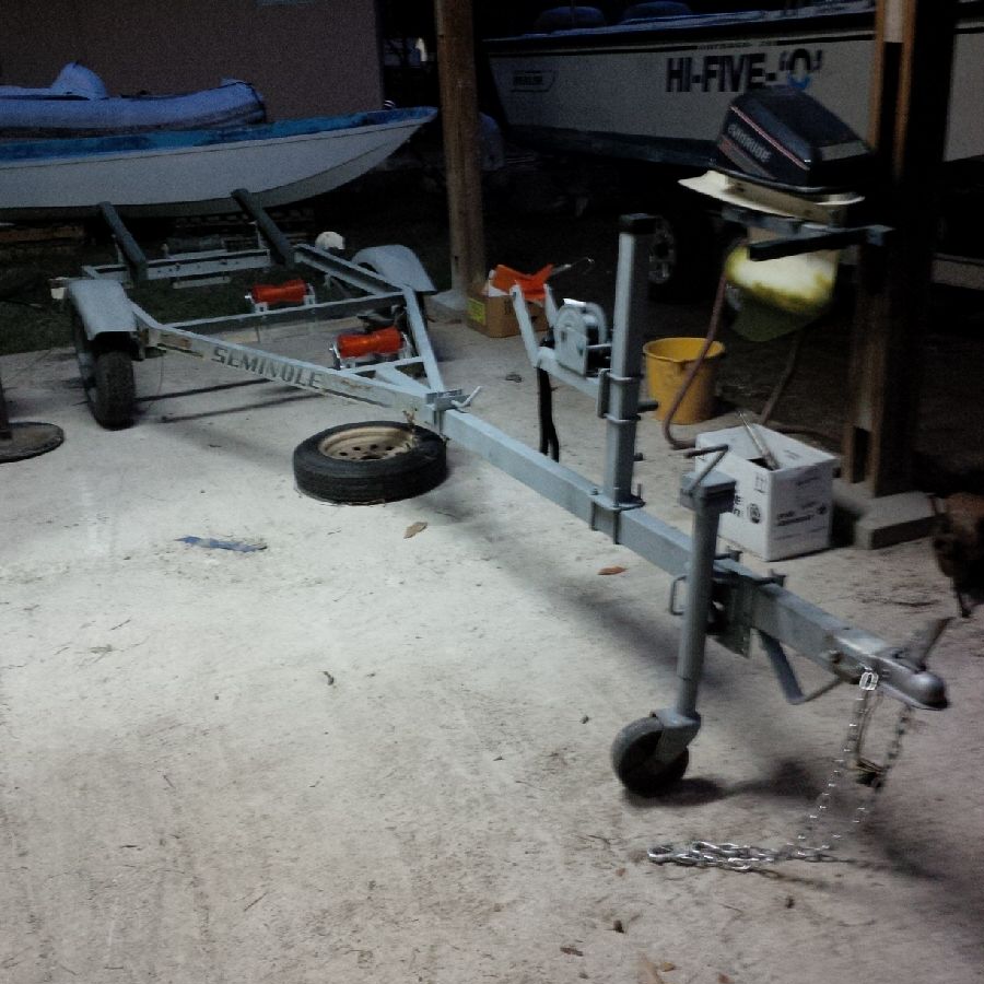

We did get a new trailer which we restored. Still have some minor adjustments to do.

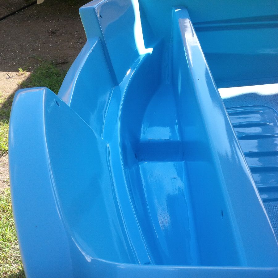

Continued;

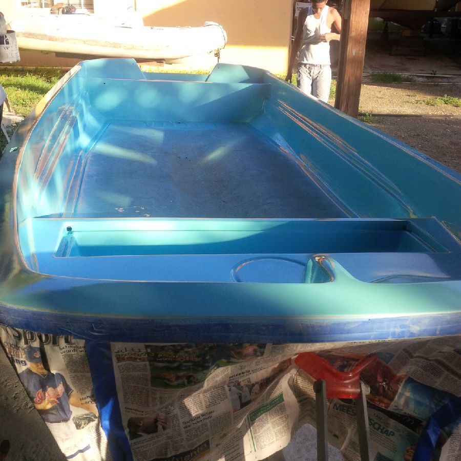

Interior paint has been added. Since we couldn't get the original paint,
we decided to mix white with blue. The paint looks good but just a little bit of green
will bring you closer to the original colour.

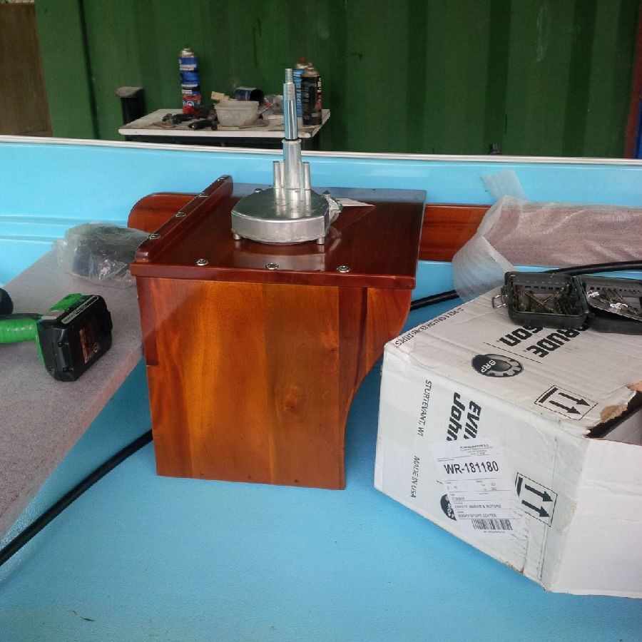

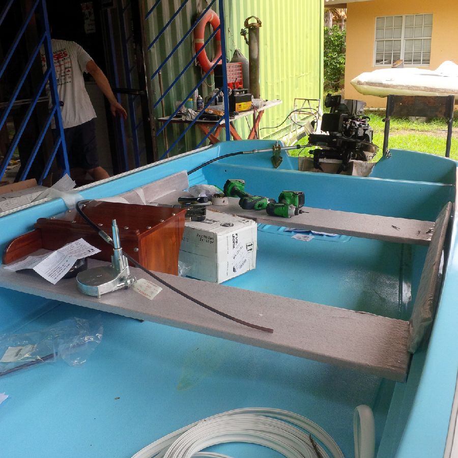

Here we have some more picture of the rigging.
The steering system we used is a bit of an older tech than
what most other boats have but we decided to use it instead because
of its simplicity and its space saving benefits.

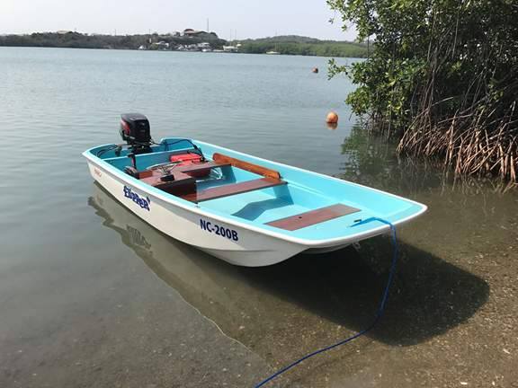

Postby Albert Jr. » Mon Apr 24, 2017 10:47 pm
Well guys we've done it, we've finished the boat.
Got to say that this build was one of trail and error but after much reworking, after much sweating, and after much whatever came out of our mouths, we've finally finished the boat.
The Tohatsu 40 is performing better than ever. I honestly have never ridden a better balanced boat than this one.
It's light, it's agile, and it looks like it just came from the factory.
I'd like to thank my dad who wen't through the project with me at every step, my glass mechanic who thought me the do's and don't of glassing, and my buyer who pushed me to do better at every step.
Lastly i'd also like to thank you the audience for all the compliments and support.
This is not the end of the road though for I have more projects coming very soon.
I'll keep you all posted as soon as the first new project gets started :D
