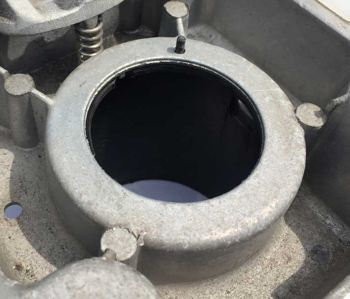

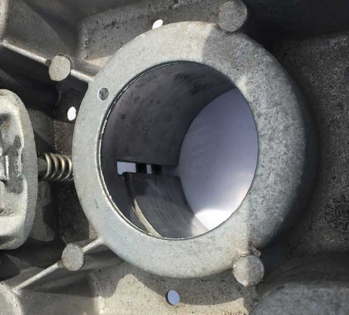

My older socket lacked any drilled hole for the bushing post to locate on, and I decided to add one. To accomplish this the seat base was removed from the seat.
Using the new bushing as a guide, and with the new bushing inserted into the socket in the desired orientation, I established the position for the locating hole in the socket's lip. A small pilot hole was then carefully drilled, and the bushing placed in the socket to check the accuracy of the newly drilled hole location. The hole was then enlarged to about 5/32-inch to allow the bushing post to completely seat into the hole in the socket and the bushing to bottom out in the socket.
Before reinstalling the seat base with its new bushing onto the pedestal post, the top surface of the pedestal post was carefully refurbished with a metal file and progressive sanding with 200-grit and 400-grit emery cloth until it was restored to a flat and smooth surface. The pedestal top had received some damage, probably from those ridges in the seat base socket hitting the pedestal post top surface after the bushing failed. To further reduce abrasion between the aluminum post and the nylon bushing, I applied a small amount of teflon grease to just the top surface of the post, being careful to not get any on the post itself where the bushing will be compressed to fix the seat in place at a particular rotation.
The restored seat was placed back on the pedestal post, and it seems to work well.
Fig. 1. Springfield Seat Base with new hole drilled for alignment pin
Fig. 2. Springfield Seat Base with new bushing installed and bushing alignment pin protruding through newly drilled alignment hole

I updated the initial post with some close-up images of the seat socket after I drilled the locating hole for the pin on the new bushing.
