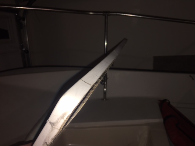

The bow locker is splitting along the corner and there is some cracking on the sides and top. Any thoughts on how to get this back together for good? I assume the cracking would be handled the same way with the Loc-tite for now and grind and gelcoat in the fall.

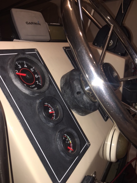

3. The gauge plate and dials are pretty dried out. How do I make them shine like new?

I assume the bow [laminated hatch cover] is hollow. Do I apply 5200 around the edges and put a weight on it [until the 5200] cures?

The bow locker laminated cover can be repaired with epoxy resin with some thickener. Tint the epoxy to an off white. It looks like the repair area will not show when the hatch is closed, so you won't have to get a perfect match.

The helm instrument panels are usually made of aluminum and are painted. To restore the color and luster to the paint, try some paint renewal treatments, or just repaint the panels with new paint. Try WD40.
The electrical gauge dial bezels are often plastic. Sometime the color and lustre of plastic can be renewed with WD40.
