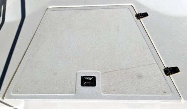

Q1: on 1996 Montauk 17 anchor locker [illustrated in Figure 1], how is the hinge fastened to the [anchor locker hatch]?
Q2: on a 1996 Montauk 17 anchor locker [illustrated in Figure 1], how is the hinge fastened to the hull?
Fig. 1. The molded anchor locker hatch on a MONTAUK 17 which is the subject of this discussion.

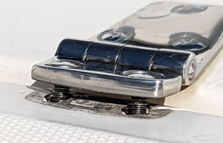

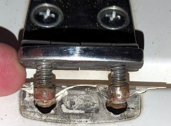

Fig. 2. Close-up of cracked gel coat surrounding screw fasteners on hull.

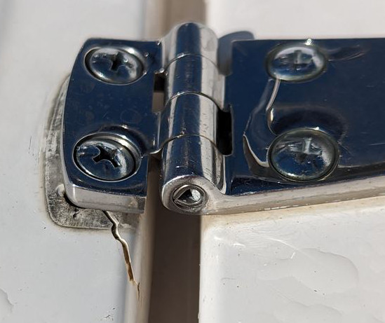

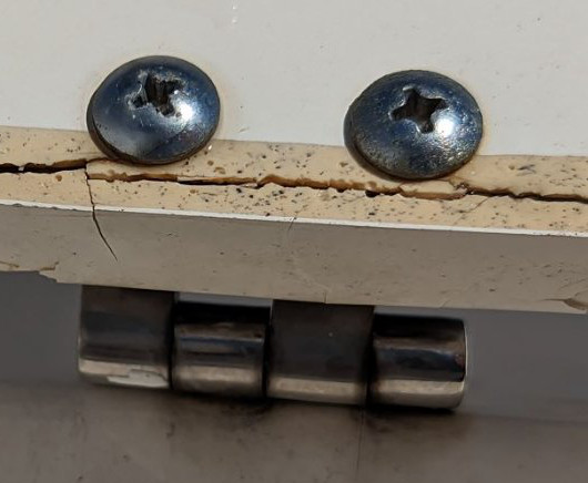

Fig. 3. Close-up of the screw fasteners on the hinge.
Fig. 4. Close-up of fasteners on underside of hinge at hatch.
The screw fasteners heads seen in Figure 4 are not connected to the screw fasteners from the top.
On my 1996 MONTAUK 17, on the [molded] anchor locker [hatch], one of the two hinges has broken loose [from its connection to the hatch]. The screws [holding the hinge in place] won't come out of the [molded anchor locker hatch]. The hinge is [loosely] attached; [the attachment of the hinge to the hull is] still tight.
I believe someone must have tried to close the hatch with a rope or something in the way, and the hinge fasteners were the weak point.
The surface of the [anchor locker hatch] under the hinge has split open. The screw threads look like machine screws. The screws come out three or four turns, but then just spin loosely and won't come out all the way, even when pulling them with pliers.
I'm guessing there must be a nut on the other side of some sort that has broken free of whatever was holding it.
Most of the visible area is still intact. I would like to figure out how [the molded anchor locker and the hull are] constructed to give me a better idea how to approach [removal of the broken fasteners] without causing too much unnecessary cosmetic damage.

You mention the screws on the bottom are not connected to the screws on the top which I find hard to believe as the location and spacing seem identical to to the screw location on the other side. What happens when you try to loosen the screws that are on the underside of the hatch? Just looking at the topside and bottom side it appears that a pair of sex nuts are used on the bottom and machine screws on the top side. The threads might have become galled and you may have to cut off the screws but it looks like you have enough room for a metal cutting blade to get in there. Oscillating tool with a quality metal blade would be my tool of choice to cut through the bolts. Let us know how the repair goes.

Your thought [perhaps directed to the comment by MakrCZ] was my initial thought, too, but the top screws are rattling around while the bottom screws were tight when I tried to move them.
I'll put more torque or maybe the impact driver on the bottom screws and see what happens.
Logically I can't think of any other way they would have done it, especially given the orientation of the top and bottom screws to each other. They must have broken inside somewhere, leaving part of the female side stuck on the male side, keeping the top bolts from falling out.

It seems very likely that barrel nuts were used to hold the hinge on the hatch side.
As for the screw fasteners holding the hinge into the hull laminate, if they are definitely machine screws, they are probably threaded into a material called whale board that can be tapped to hold a machine screw. Work carefully with those fasteners. If you damage the embedded whale board threads, further use of them will be difficult.
Also, that long crack running across the anchor locker hatch seen in Figure 1 is unusual. It may be a result of the same forces applied to the hatch that broke the hinge screws.

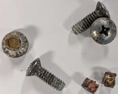

Update: [the fasteners used on the hinge] are indeed barrel nuts.

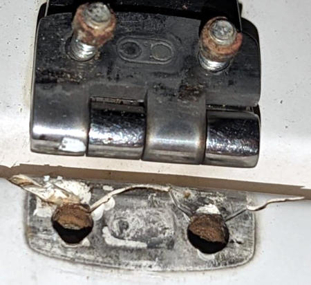

Fig. 5. Broken fastener hardware.
Fig. 6. Removed bolts.
Fig. 7. A cracked lid.
Although these barrel nuts looked very nice on the outside, they were clearly corroded on the inside. The bottoms were held snug by corrosion, a good twist and the came free. I used an old drill bit as a drift and the top parts came right out with some very light tapping.
The associated screw fastener is good stainless steel and it has no corrosion.
The metal of the female side is copper colored--I wonder if it was actually copper. While [the corrosion is\ frustrating, to be angry [about the corrosion] after about 27 years of year-round use in saltwater would be difficult.

I don't see anything in Figures 5, 6, and 7 that looks like a Barrel Nut.

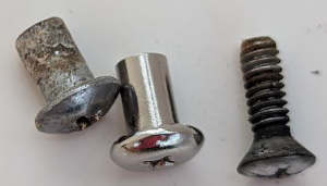

The hatch is fixed. [The fastener that holds the hinge to the molded hatch top] was for-sure a barrel [nut] . The dimension of the barrel [nut] was 3/8-inch long with 10-24 threads. A replacement was ordered from Hamilton Marine, their part BEC-BB187S01 and installed.
Fig. 8. The actual package from a vendor from whom BARREL NUTS were ordered. Note on the package the vendors calls these products BARREL NUTS. The vendor does not call them BARREL SCREWS; please take note of this when describing these products in the narrative of this discussion.
Fig. 9. Three fasteners in various stages of wear. On the left is an old barrel nut. In the center is a new barrel nut. On the right is an old oval head machine screw.

Looking at the pictures, I wonder if the original [barrel nut] was aluminum.

Regarding speculation that some component used to fasten the hinge on the 1996 MONTAUK 17 boat under discussion might have been made of aluminum: I doubt that Boston Whaler used aluminum hardware. Maybe a previous owner got an aluminum barrel nut or an inferior steel barrel nut from Ace Hardware. Maybe the OP can send you the old barrel nut for metallurgical testing. Contact the OP to follow up on your speculation.
Figures 5, 6, 7 appear to show a badly corroded barrel nut in which the threaded portion of a screw fastener has corroded in place and broken off in the barrel nut flush with the end of the barrel nut.
