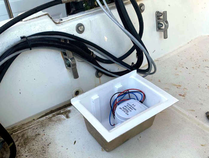

Fig.5. New 130SS with Bilge Pump Installed per Jefecino Logic
Maybe other whalers are different. I don't know. I do know that this whaler isn't a collectible or anything special, so I'm gonna 3d print another mold for my revised sump and show you guys how it turns out when I finish.

The centrifugal pump seen in Figure 5 was probably mounted on the starboard side because the helm is also on starboard, so the boat probably has a list to starboard when the helmsman is sitting at the helm, keeping the cockpit water toward starboard.
The battery is not in view. Because the engine cables are all carried forward, I suspect the battery is under the helm seat. There appears to be a fuel tank in view on the port side under the helm seat. The battery is likely to be on the starboard side under the helm seat. That weight distribution further tends to put the trim to be a list to starboard.
The engine cable rigging is well done as it keeps the cables clear of the cleat fittings. Compare with Figure 1.
The boat seen in Figure 5 appears to be on display at a boat show. Perhaps the pump at the transom was a factory option or maybe a dealer-installed improvement.

its pre owned, battery and fuel tank are both to port. I doubt a dealer would install a bilge pump unless a sale depended on it. My point with that image was if the hull is perfect and the concern I describe is imagined, this person must also be imagining things. There are plenty more of these 130SS models with bilge pumps lackadaisically thrown on the deck...

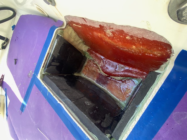

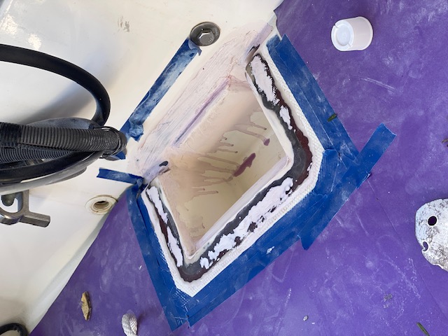

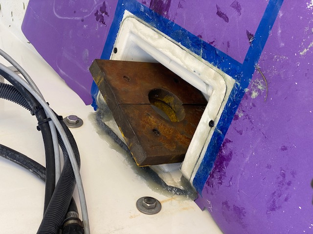

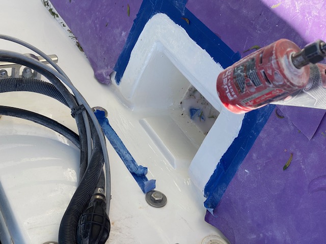

The creation of a new cockpit sump area and its addition to the hull of the 130 SUPER SPORT is shown below in several posts.
I began by designing the plug-mold for the bilge pump sump in CAD, and then 3D printed the plug of the mold out of ABS. I coated it in PVA and used a mix of chopped strand and cloth to build up the part in the mold to get the thickness to surpass the floor thickness.

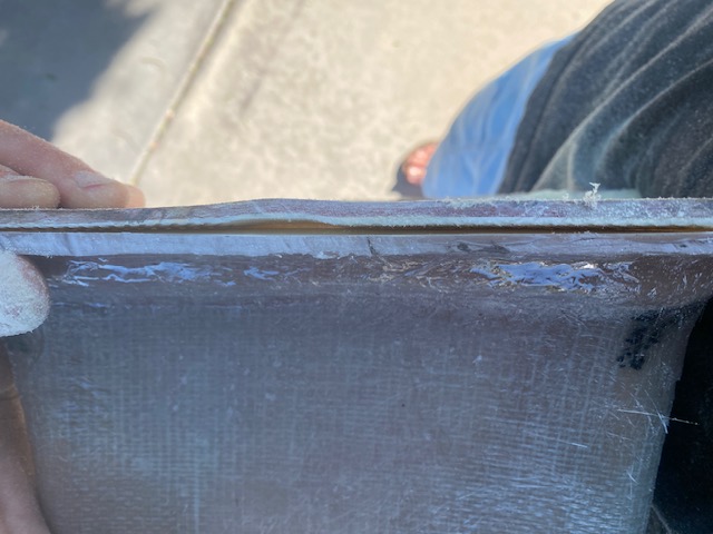

Fig. 7. The thickness of the molded sump part compared to the laminate thickness of the deck that was cut out.
I cut out the floor and removed the foam so the sump box would fit nicely.
Fig. 8. The laminated sump and the cut out section of deck with interior foam removed.

I undercut the foam under the floor so I could fit 3/4-inch-thick black Coosa board. The Coosa is laid in so half is under the deck and will be under the lip of the sump box. The Coosa board was adhered with a lot of thickened resin and glass.
Fig. 9. Coosa board reinforcements in cut out area.
I bonded-in the sump box with more thickened resin. While hard to tell, the whole aft portion of the sump box is flat, and bonded to the transom, and the sides were bonded vertically and horizontally to the Coosa board.
Fig. 10. The sump box bonded to the hull. The object sitting the sump [is not identified but perhaps is a weight].
Fig. 11. The sump box joint to the deck and transom was deepened to a V-shape; chopped strand and cloth with resin holds everything together.

I started getting the mating surfaces flat, using gel coat to see where my low and highs were:
Fig. 12. The start of fairing the joint between the new sump and the hull.
And repeated the gelcoat - sand flat process a few times, and going further outward each time until I reached my tape line for the transition to nonskid
Fig. 13. The joint line is now all gel coat resin and flat.

As a final steop, I 3D-printed a cover. Then I gave the boat a good cleaning. I am happy with how it came out.
When you whack the new sump part, the sound is dead, not hollow at all. I noticed this after the part was just bonded-in, before the fiberglass joint was added.
Although I had 6-lbs density foam on hand, I opted not to use after I realized how strong this new part was. I felt using foam was unnecessary, and there was no reason to risk overfilling and bulging the surrounding floor.
Fig. 15. The new cover in place and a clean cockpit.
Fig. 16. The sump pump installed in the new cockpit sump and an output hose rising over the transom.
The setup works really well for cleaning--even in the driveway, I used to dread cleaning the cockpit. The boat is much more livable with the water automatically exiting. The rear gutter works beautifully with this sump, all the water drains into the sump and doesn't collect anywhere else.
Fig. 17. The sump pump working to remove water.

Summary of laminate layer thickness
    Hull bottom: 1/4 to 5/16-inch thick in most areas, with reinforcement in areas of high stress or high likelihood of impact
    Deck fiberglass section: 1/8-inch thick
    Deck gel coat section: 1/16-inch thick (including thickness of raised non-skid)
