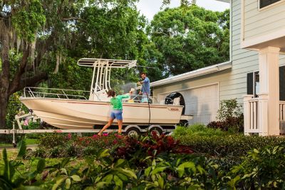

Rather than trying to get a survey response that would have a valid sample size, I would proffer that the most common trailer found in use for a 190 MONTAUK would be the model that is available at time of purchase from Boston Whaler.
In the specifications, the number of axles on the trailer is not called out, but there is an illustration that shows the trailer is a tandem axle model.
Fig. 1. Illustration on Boston Whaler website showing optional trailer for 190 MONTAUK. Photo courtesy of Boston Whaler.
On that basis, to me the prudent choice is to get the tandem-axle trailer, even though it will cost more, will weight more, and will be somewhat harder to maneuver than if you got a single-axle trailer with a capacity rating that was just enough for your particular boat.
