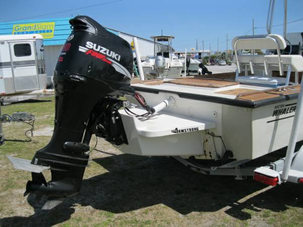

I have that exact boat. Below is a picture of her when she still had the Armstrong Bracket. Performance was very good. However, I have subsequently eliminated the Armstrong Bracket in lieu of a 12 inch setback with hydraulic jack-plate. This particular setup provides a varied amount of adjustment to the height and angle of trim that gives me greater control over the ride. I would highly recommend it.

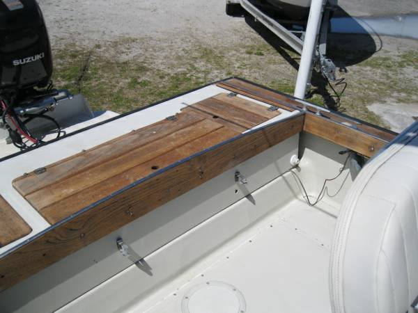

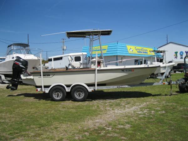

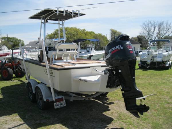

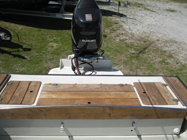

This was recently on Craigslist for sale. I really like the Armstrong bracket on the transom for this SeaDrive 18. Though I was they had done a better job color matching the transom work..

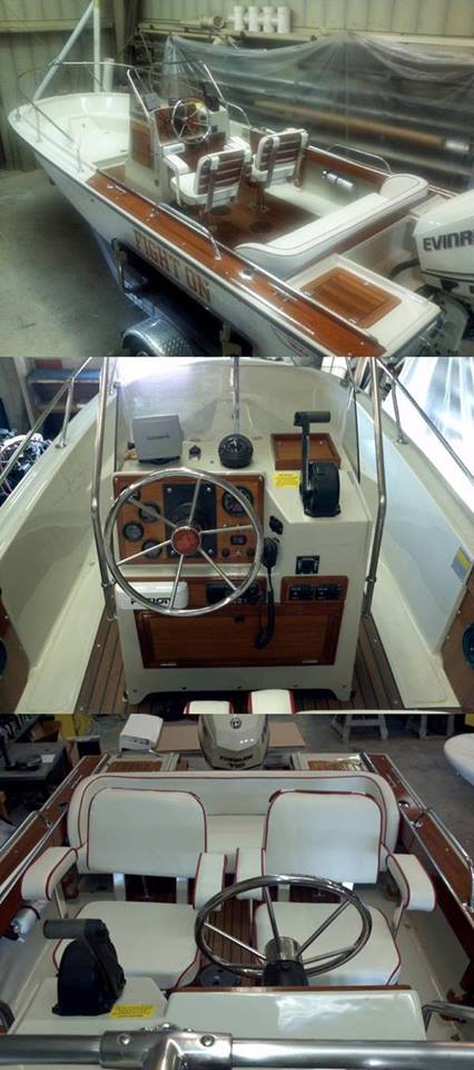

Also, Here is an interesting SeaDrive conversion that was for sale here in Detroit a few years ago. It had the closed transom altered into a modified notched transom.
