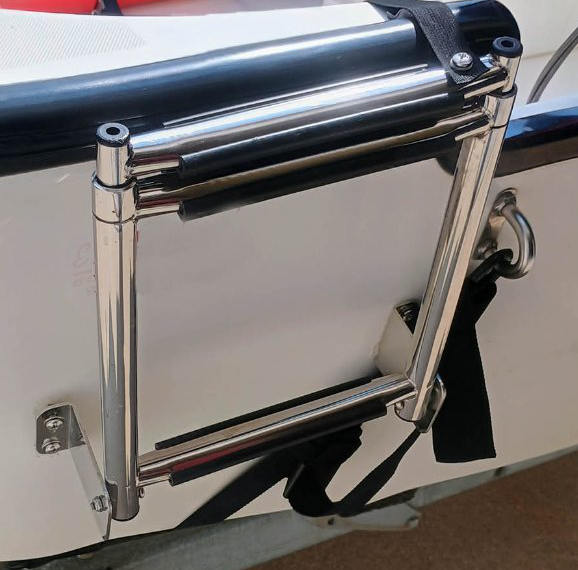

In c.2023 I purchased a 2003 SPORT 150. In 2025 I added a boarding ladder, which I mounted on the Port side of the transom using four #12 two-inch stainless steel screws, threading the screw fasteners though the hull laminate and into the foam. There was no way to use through-bolting and backing plates on the Port side of the transom because the cockpit has a molded-in seat at that location

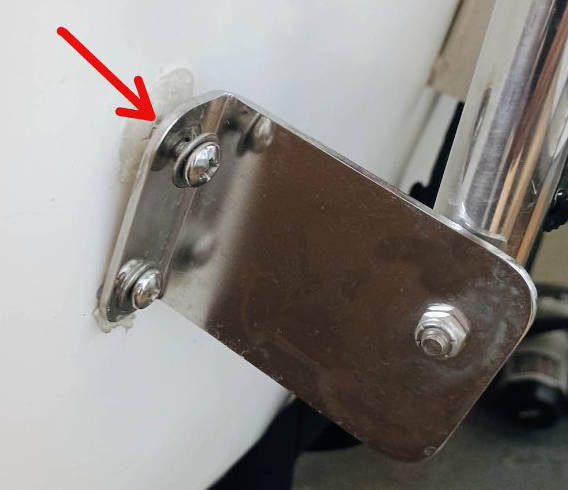

I wasn't completely comfortable mounting the ladder this way, but I saw no other options. Of course, the obvious happened - the top screws are starting to pull out.
Fig. 1 . A loose screw fastener.
Fig. 2. Transom of boat with boarding ladder

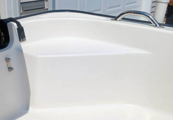

Fig. 3. The molded-in seat at Port Aft of cockpit.

You can still locate embedded wood or phenolic reinforcements in a Unibond hull using the tapping method, that is, you tap the hull with a wooden or plastic handle of a screwdriver, and listen for the sound to change when you tap on a reinforced area compared to an area with no reinforcement.
You may be able to locate embedded reinforcement materials on the transom which were put there to allow mounting a boarding ladder.
If none of the steps mentioned above provides any clue to a reinforced area on the transom that would be useful for attaching the boarding ladder, you can make you own. See this article for a brief description of the process:
Repair of Loose Screw Fasteners
https://continuouswave.com/forum/viewtopic.php?t=3224
The method described in the linked article above may be your BEST choice, no matter if you found reinforced locations or not, because it will allow you to re-use the existing holes you have already made.
Also, when you create the embedded epoxy resin annulus under the laminate of the hull, you should strongly consider tapping the fully cured epoxy for a 10-32 machine screw. I think a 10-32 machine screw will probably get a very strong purchase into the cured epoxy and be more resistant to being yanked out than a self-tapping #12 screw.

I don’t believe the 2003 has the reinforcements. Later years do have it. They contain phenolic which can be drilled and tapped. Your best bet will be the ‘hockey puck’ approach of finding some type of marine toggle connector and combine this with the hockey puck approach. You can Google the hockey puck method. Basically you eliminate the foam in an area behind the hole, inject epoxy into the hole, then drill and tap the hole for your screws. Not an ideal connection for your ladder. I’d be tempted to look into an engine mounted dive ladder or something.
