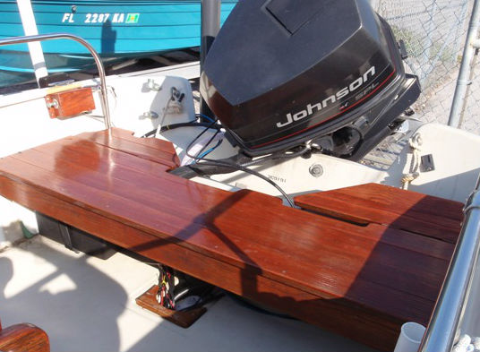

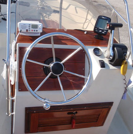

I have a newly acquired 1988 Whaler Montauk 17. Is the wood on the console factory original? Or, a later added custom item? I am relatively sure the back seat is custom. Has anyone seen a console with [wood added]? Thanks--Tom

Re: OEM console or aftermarket custom design?
The fiberglass console is original. The wooden gauge panel and top shelf have been added--a nice touch.
Re: OEM console or Custom Design
Many owners of classic Boston Whaler boats add wood trim to them in various places.
Re: MONTAUK 17 Console with Wood Trim
The wood is likely due to some modifications (newer engine for example or fish finder). Often these changes over time leave the console looking like swiss cheese. -- Hence the aluminum gauge plates (where the helm is) and the top wood top plate have been replaced with teak or mahogany.
The rear bench seat is nice, and will add functionality to the boat in a general sense. The rigging tunnel cover is also changed as it is typically a rectangle, and not the U-shape as shown. Plus the wood enclosure for what looks like the [electrical connections for the navigation lamps].
All of these look well done.

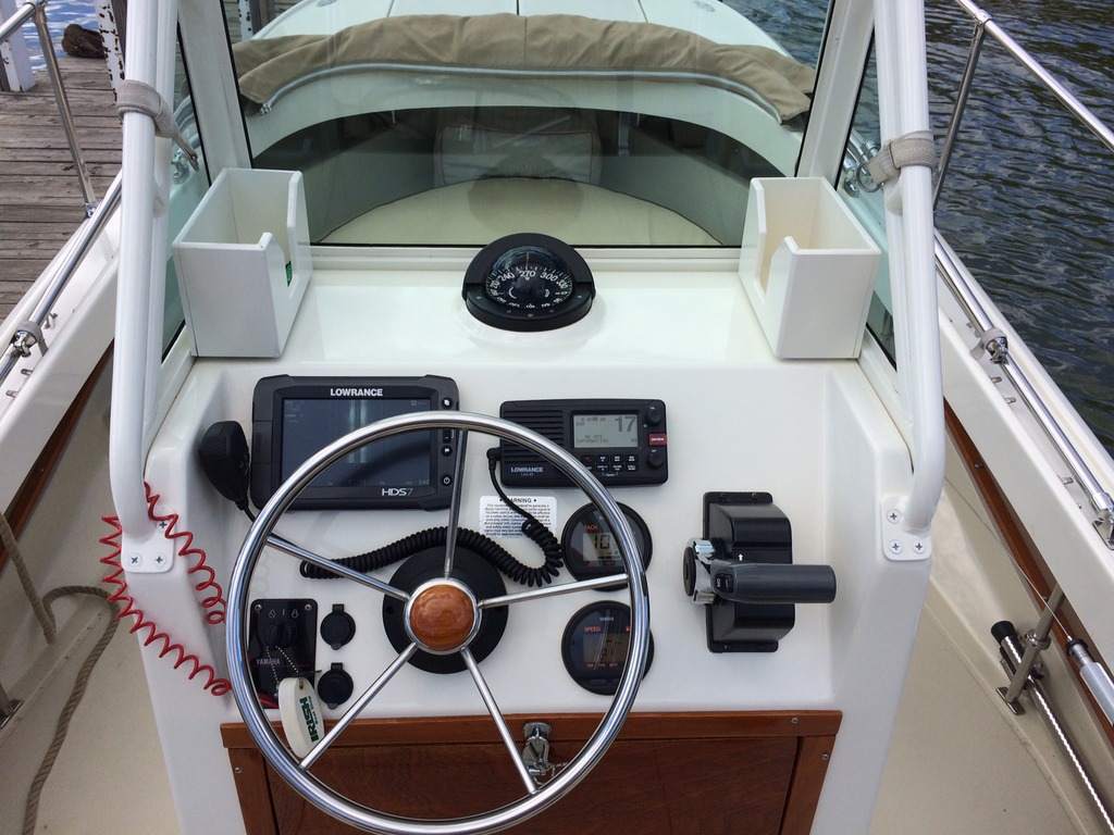

I prefer in-dash mounting as opposed to on-top of dash, a personal preference. Makes it more difficult to remove, especially on a daily basis for theft prevention. And it keeps the connectors protected from the elements.
I think Whaler took a step back, when moving away from the large slanted dash. Lot's of room for flush mounting, uh, stuff:
The two plugs to the right of the ignition switch are a standard cigar lighter power jack and a double USB charger power jack for phones and pads.
