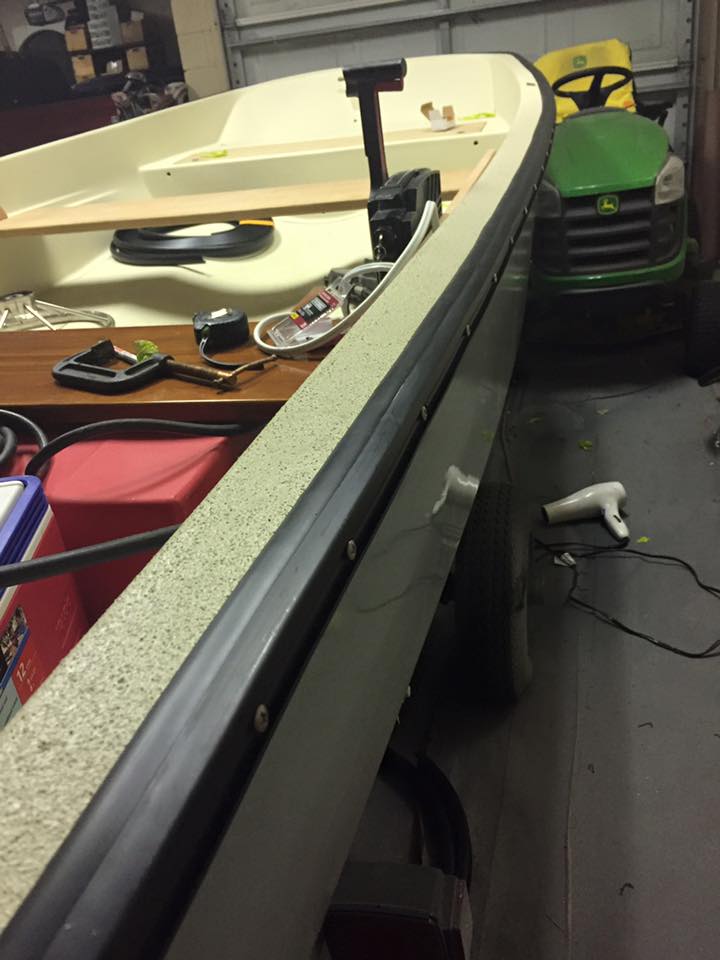

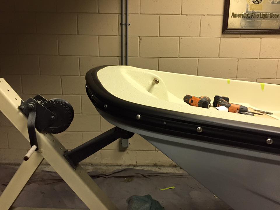

I went with #10 pan head screws on mine. Tried a couple with #12's, but it showed too much when you put the insert in.
I was able to do the complete install by myself, but if you have a helper, it will definitely go smoother. I used the quick clamps and did a small section at a time as I worked my way around the boat. Started about 2 feet from the transom on the port side. Pre-drilled and sank the screws in place. Then once the entire rub rail was in place and cut to fit, I went back and caulked and used a counter sink bit on the rail to get the screws essentially flush.
I went with the all black 3 piece kit direct from Whaler.
