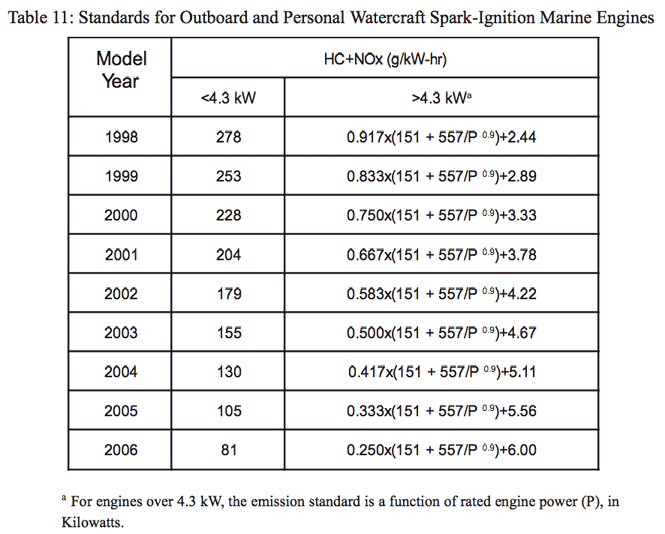

Here is a table that shows the limits of exhaust gas emissions by year during the phase-in period:
From Table 11, Page 8, Overview of EPA's Emission Standards for Marine Engines

Per online calculator: 1.34 horsepower in 1 kilowatt.
So 4.3 kW is roughly 5.7 hp.
Using 2006 limits, I ran the calculation for ">4.3kW" category of HC+NOx permittable emissions. The answer was 81.2 g/kW-hr. So the ceiling for any engine is 81 g/kW-hr from the chart. For 6 hp and above, it then changes based on power output. Note the standard is in terms of work, not power: kW (hp) for 1 hour of operation.
Ran calc for 2006 200hp model and got 45.2 g/kW-hr.
If I did the math correctly, the emissions per hp declines with rising horsepower. So that 200hp engine can emit 6748 grams per hour of operation in total.
4 hp can emit 324 grams per hour of operation in total.
NB. My math is subject to correction.

I posted the table to show how the regulated exhaust gas emission limits were phased-in. You can just look at the coefficient multipliers for the various years. For example
1998 = 0.917
2006 = 0.250
So, roughly speaking, outboard engine regulated emissions had to reduce from 0.917-of-something-per-HP to about 0.250-of-something-per-HP over the nine years. To go to 0.25 from 0.91 is a reduction of 0.667. Expressed as a percentage that is about a 70-percent reduction. So the outboard engine makers had nine years to figure out how to reduce exhaust gas emission by 70-percent, again, roughly speaking. (I am sure there is more to it than this crude analysis, but my figures show the trend line.}
For the 2+2 approach used by Mercury a 70-percent reduction in emissions may have been a hurdle that could not be overcome. Since the method of suppressing combustion in the two unused cylinders at low speed was just to make the fuel:air mixture too lean to be combustible, it is likely that some of the hydrocarbons in the unburnt fuel were going out in the exhaust and being counted as exhaust emissions.
Note that the EPA allowed credits to be earned and applied, but in the case of Mercury they already had several noncompliant engines (like VERADO) which needed those credits to permit them to be sold. This probably further doomed the 2+2 to be an end-of-life product.
