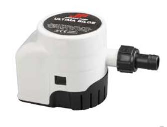

Jim - all very interesting points. I do think this is a very proven design and a mechanical float is very reliable. I also find the price to be expensive for a recreational boater. The attachment system seems to be solely designed for round pumps if your were to have a different pump design I am not sure how you would use this switch. For example this Johnson 1000GHP pump:
