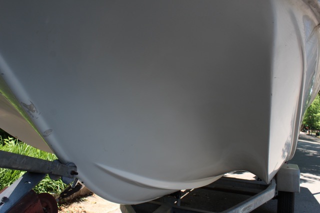

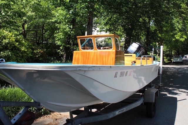

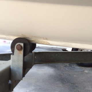

I recently acquired a 1971 Boston Whaler Nauset that is in excellent overall condition. There are a few areas on the bottom of the hull where the gel coat has been damaged by an incorrectly fitted trailer (which I am replacing with a new trailer). In addition, there was a hard hit at some point at the rub rail height on the port side which needs to be repaired. I would like to have the gel coat restored to original condition and will probably want to buff out the entire boat when this is complete. I have also ordered a new rub rail that will be installed. Looking for a recommendation on the best fiberglass repair shops in Michigan to complete this work.

In the pictures posted above the damage appears to be confined to the hull keel. Since the hull keel is not visible when the boat is in use in the water except to fish and divers, there really is not a particularly essential reason that the repaired area be absolutely undetectable by eye--no one is going to see it unless the boat is on the trailer and you take it some sort of boat show competition for restored old boats.

Just an unsolicited thought; that trailer roller you show is adequate. I might think of replacing it with a wider, poly roller, if practical might look at the others while you are at it. Easier to hit, non-marking and it will keep the metal supports farther from your hull on the average day. Replacing old rollers is always a good thought. Each time I have seen one fail, I had the thought, "that roller is not real old"; but it was always much worse than it looked. Thank You all for indulging my wanderings.
