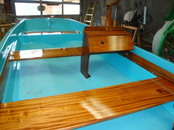

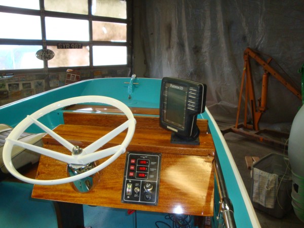

I rebuilt my Helm, used Mahogany after making patterns out of MDF, bought a damaged sheet at Home Depot for $3.
wood 2.jpg (67.29 KiB) Viewed 5516 times
Helm Face.jpg (69.02 KiB) Viewed 5516 times

Great deal on all that fine mahogany for $3. You got a bargain.
