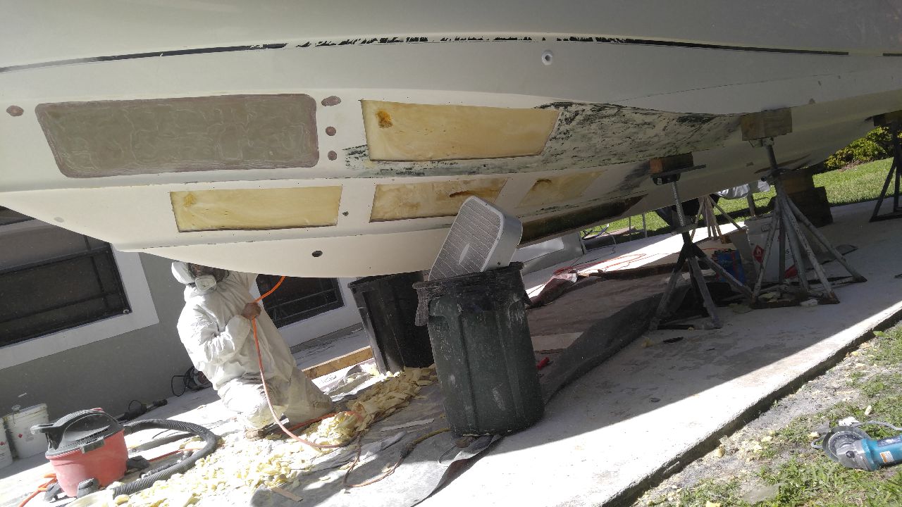

Hi Joe . Did your boat have a name[?] I purchase a similar boat some years back. We ended up fixing it from the bottom by creating a stringer system.

Yes that was [the same boat]. I still have your hats. Great boat after we repaired [the hull]. The boat is now in Martinique, France. I have pictures of the repairs. We perfected what I consider a Boston Whaler glitch in 1999. I have another Boston Whaler boat from the same year: it has the same hull problem.
Fig. 1. Repairs to hull of Boston Whaler boat, possibly a 1999 28 CONQUEST

The account of the repairs to the c.1999 CONQUEST 28 hull seems somewhat familiar to me. I believe there may have a been a report of a similar problem with that same model, or at least a similar model from that same production epoch. As I recall, a big patch of the hull delaminated from the interior filler material. This occurred while the hull was still under the 10-year-warranty--or close to it--and the boat was repaired by Boston Whaler. I can't find any old thread that describes this, but I do have a recollection of it.
