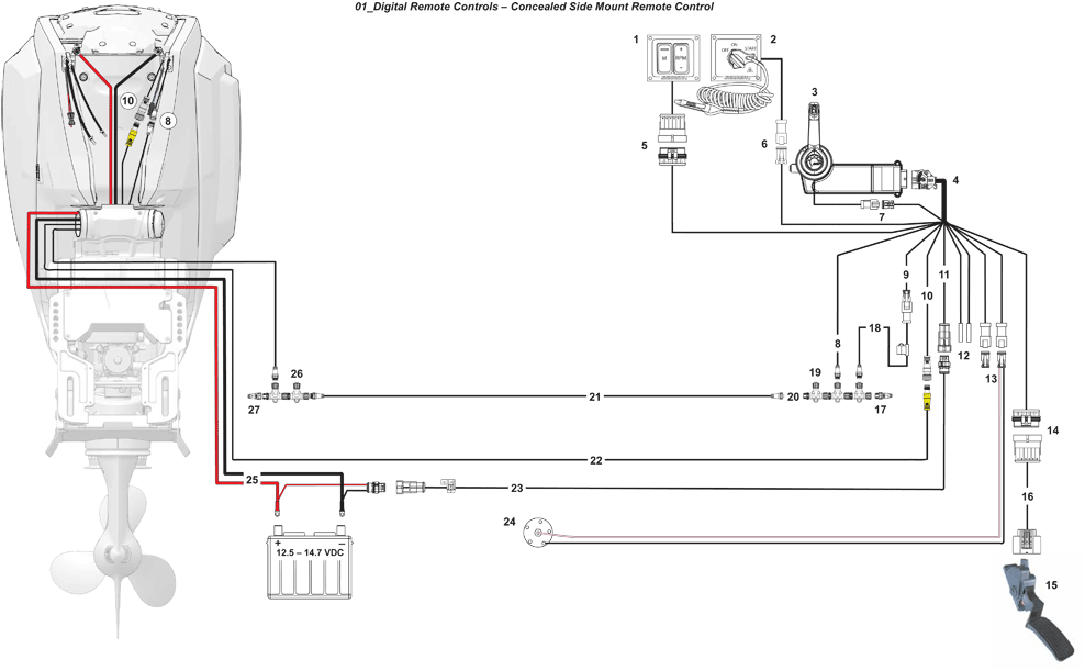

Postby jimh » Fri Apr 21, 2017 2:06 pm
Here is the wiring diagram for a single E-TEC G2 engine and a concealed side mount control:
The callouts are as follows:
1 - Mode Switch                                      15- Foot Throttle Floor Mount
2 - Key Switch 16- Foot Throttle Harness
3 - Concealed Side Mount Controls 17- Terminator Kit
4 - Remote Control Harness 18- Power Node and T-Kit
5 - Mode Switch Connection 19- Connection to NMEA-2000 Digital Display
6 - Key Switch Connection 20- Connection to NMEA-2000 Network
7 - Trim Switch Connection 21- NMEA 2000 Extension Cables
8 - Remove Control to NMEA-2000 Network Connection 22- Backbone Bus Cable
9 - Accessory 12-Volt Power Out 23- Network Power Cable
10- Remote Control Network Connection 24- Fuel Tank Sender
11- Network Power In 25- Battery Cable
12- Oil Level 1 & 2 26- Connection to NMEA-2000 Acessories
13- Fuel Level 1 & 2 27- Terminator Kit
14- Connector Accessory Foot Throttle
This is from the rigging guide for the 74-degree 3.4-liter V6 engines, but I would assume the same rigging is used with the smaller displacement V6 G2 engines.
