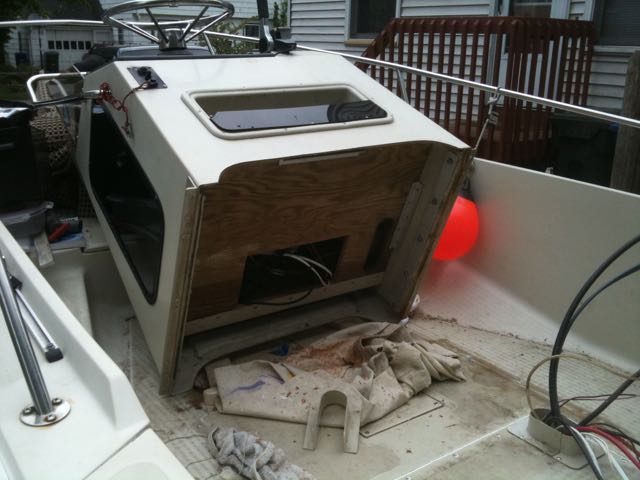

On my 1983 15' Center Console I hinged the front which allowed me to simply roll the console forward when I worked on it. Very convenient. This worked well because the console was straight edged.
Great access. You can see one of the hinges here.
On my 1997 17 Outrage II I couldn't hinge the console because it was curved along the front edge. But, It was still simple to remove the screws and roll the console forward.
This is before I started cleaning and working.
It sure made re-wiring and moving things around a lot easier.
My current 1999 21 Outrage has a T-top, so no more rolling the console forward. Fortunately the console is big enough in this boat to get inside and sit while working 'behind the scenes'.

Duane, thanks for the response and great work!!
I'll have to look at the leading edge of my console, but I now know at a minimum, I can tilt it forward.
PK

ASIDE to PORTHOLE: heya, Duane, that was very nice work on the re-fit of the console wiring and steering. Thanks for sharing the images with us.
